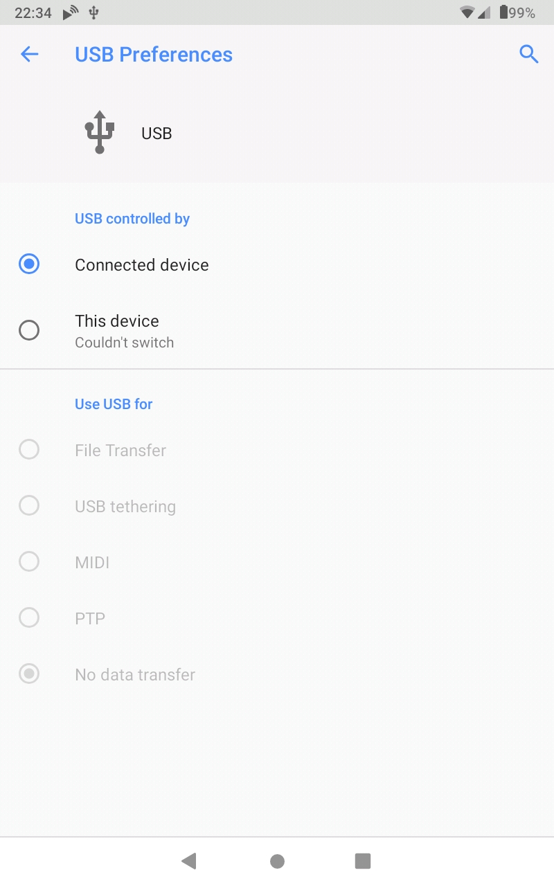

I did that, but via dev options, set it on file transfer, didn't help!
When I'm trying to do this now, via USB settings, it won't let me to switch, see on the attached screenshot, dunno why!
Defo some kinda glitch here, but since I can set file transfer via dev options, it shouldn't be a problem...
So as I see it, it's a software problem, mainly Android P problem!
Because some dude says that it's a hardware problem, many people can't make that switch as stated in here: https://support.google.com/android/thread/20866882?hl=en
on many different devices, so he argues that it's a hardware problem! G, how can it be a hardware problem if it's the same on all the devices that use Android P, obviously it's a software problem!
I dunno what to do next, seems like it's not solvable, should I still try to get it to the service center, is it even logical to do so?
