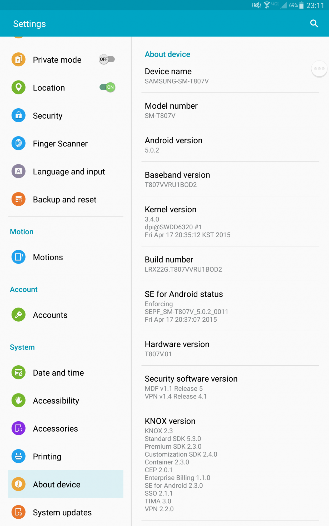

Been having a major problem with the screen freezing. Not freezing to the point where you can't turn the tablet off. When it does freeze, I simple hit the power button, unlock it and its fine...for a little while. It was doing it before the lollipop update, but it is worse now. It's safe to say that it freezes every five minutes or so. I did a factory reset on it last night, it was freezing before I could reinstall any of my apps.
