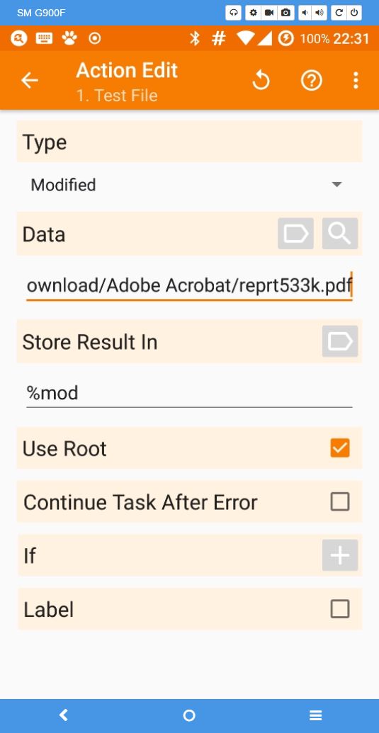

Here is a small update...
I'm trying to use the Test File' action in the task...
Here is as the command looks like:
Here is the command's output:

So, what's the problem? what's wrong? It seems I gave the SDCard access rights to the Tasker (even the file is in the internals storage) ... Why Tasker is not able to examine the file?
Could please someone try this command on his/her phone and see whether it works?
Thank you!
