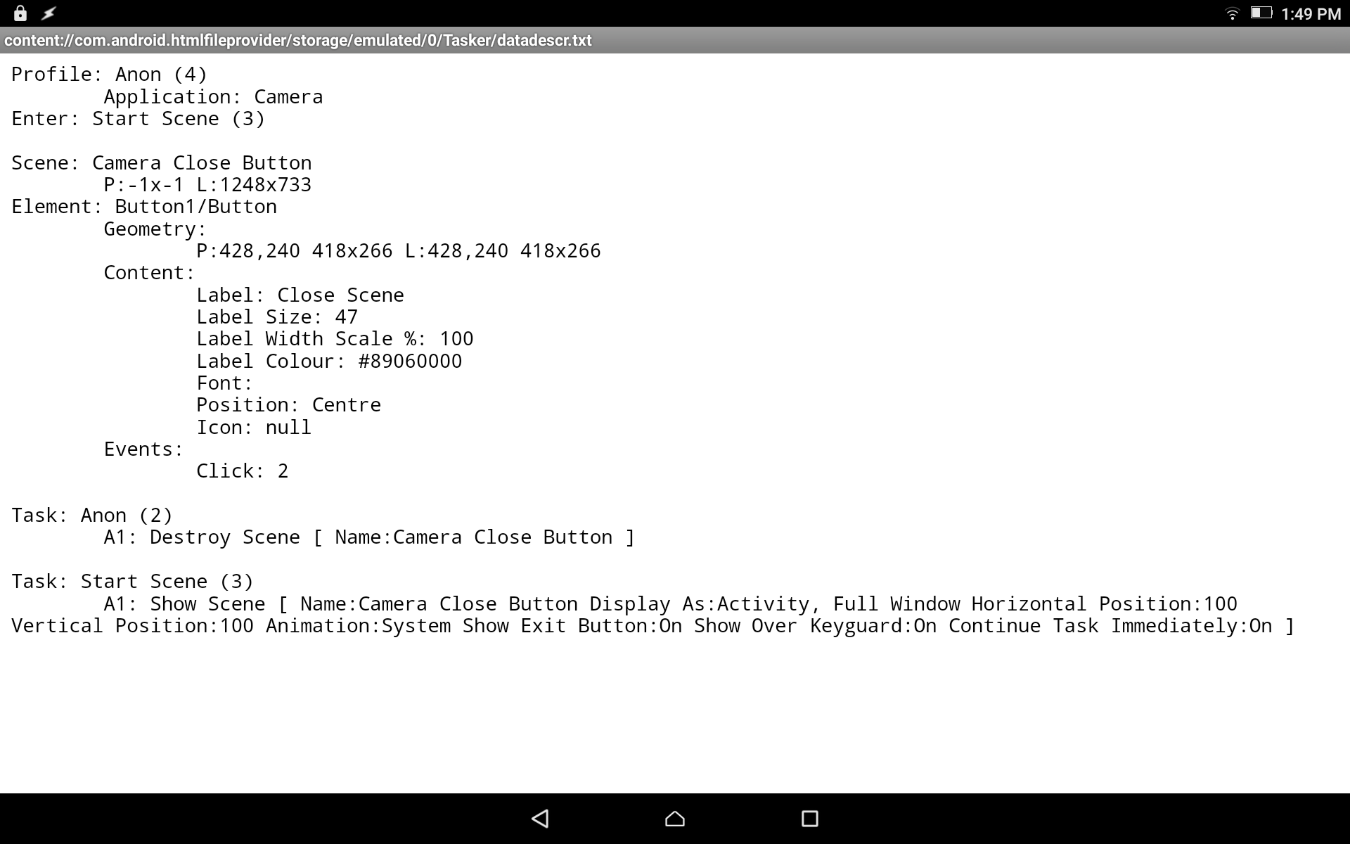

OK, so I have installed Tasker on a new Lenovo tablet (same model as the others) to test my methods. I created a Project, one Profile (When Camera starts, run Task) the task only runs a scene that pops up a button to close the scene ( the text on this scene button is different than the other). I ran the Profile description and it is attached. I created the app, still doesn't appear to monitor the profile.

Does it run successfully on the old machine under Tasker?
Was the Profile On when you created the App and then turned Off when done?
On the new machine ...
Tasker is not needed.
With the app installed is it listed for Device Administrator and if so did you enable it?
Did you reboot after enabling it?
I admit to being confused as to what you are trying to do. For simplicityyou could try a test that does not use a scene.
... Thom
