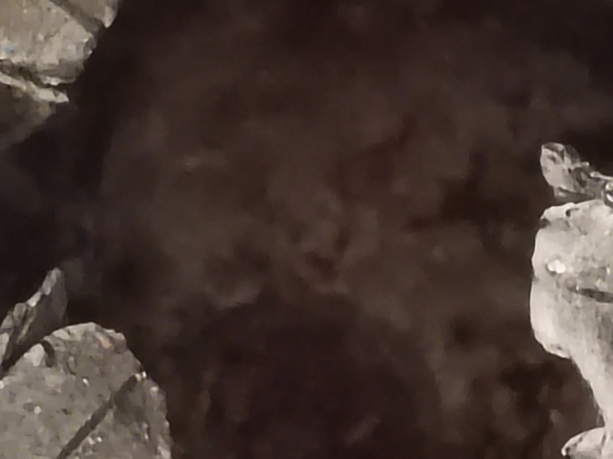

I tried to take some photos. Of course they're not very good and most likely useless for diagnosis. Here goes...y

It is apparently done. I had a guy who knows about these things check it. I guess ir's good to have a new one but Badger is probably out of the budget. What do you suggest?
