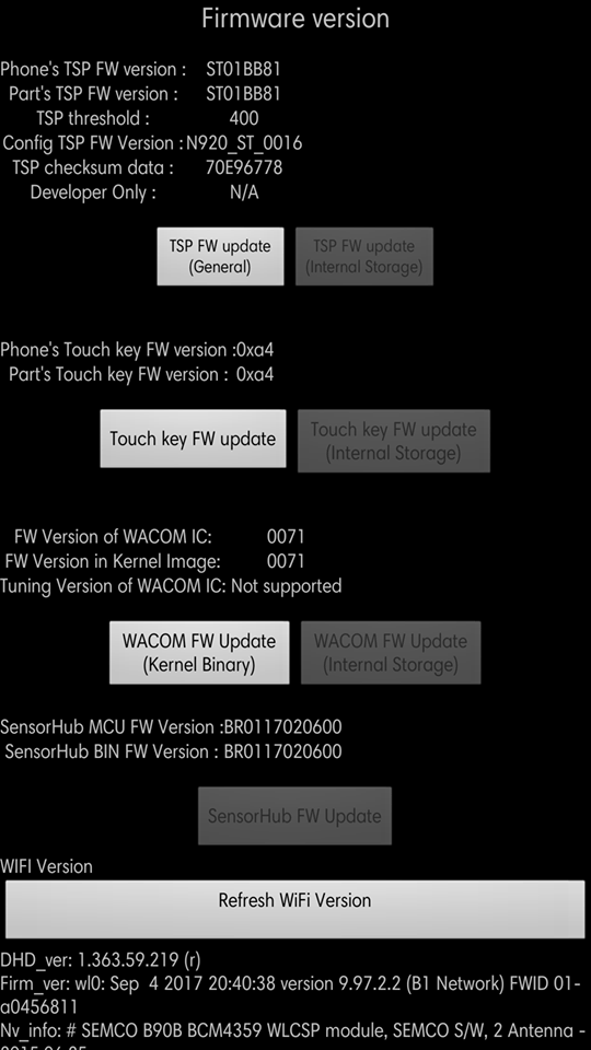

After that update, once I turned on my phone, the same problem with my touch sensitivity and input-output response started occuring once again. And once again, I proceeded by applying the same method to fix it:
On the dial pad, I'd enter the following:
*#2663#
so that I could access this secret menu:
Here, I would tap on the Touch Key FW Update and wait for the process to be completed with a PASS confirmation message.
This apparently solved my problem once more, except that the following day, upon turning on my device, the screen was experiencing the same issues.
So then again, I tried and tried, but it just keeps randomly triggering the sensitivity problems.
I even tried with the other updates of this menu, but nothing seemed to have fixed it.

Whenever I manually update the touch drivers through the special menu (tapping on all of the three options), the fix is only temporary for an undetermined amount of time. Which means I have to repeat the operation multiple times during the dya, specifically every time my screen just goes nuts.
