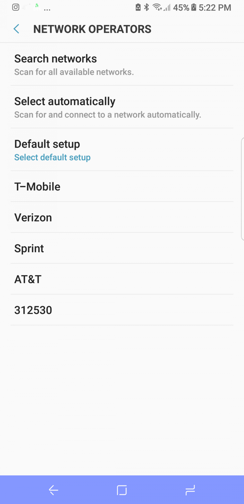

Hi people. I have a little issue here. My S8+ stopped connecting to my T-Mo network all of the sudden. Before going to bed last night everything was fine. Was texting, remember went online....was working fine. But today, I wake up, pick the phone up, and "no connection". Meaning can't make calls. Says "not registered on network". Searching for a network manually, finds T-Mobile network along with few others, but pressing on T-Mo, a message comes on "Registering on Network", after few minutes of trying "Unable to connect. Try later"... Anybody know whats up here??

I can probably go to that same store and try everything you say, but IF I WAS ALREADY THERE, WOULDN'T THOSE GUYS THINK OF THIS??
It wouldn't see any if that would be the case I think...
Did you buy the phone new or used? If the latter, I presume the T-Mobile store checked the phone wasn't IMEI blacklisted? Because what you described does sound like that.
Yes agreed! If the phone has been marked as blacklisted the phone will not allow a signal to pass through the phone. You can check if its blacklisted by taking the phone in to be investigated
