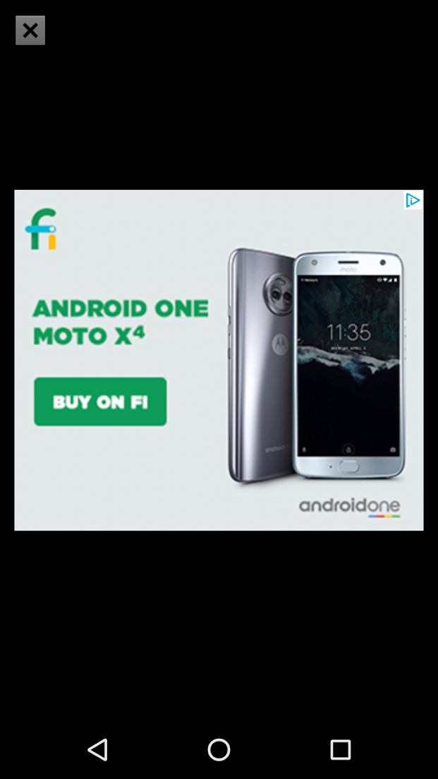

Ah, yes, if this helps.

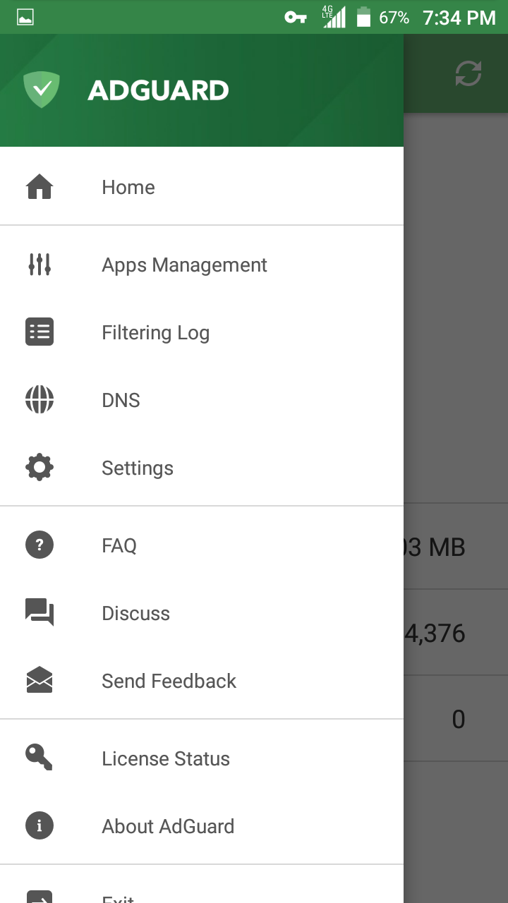

Installing AdGuard on my phone forces me to install a compatible browser, and I see no option for logs. Can't find any log files on my phone, even after an ad popped up.
First of all you have to install Adguard CA credentials to run on your device.
In the lift upper corner where the horizontal lines are take that and open it and this is what you will see then tick
filtered log
Here is the log on what's running on device including apps and including hidden indignities. Now the log that I have presented is all the sites that has ping Chrome browser while I was logged into Android forums, now I have neither tweeter nor Facebook on my device,so this app is this just shows you what type of web crawling is going on that you didn't know about.
