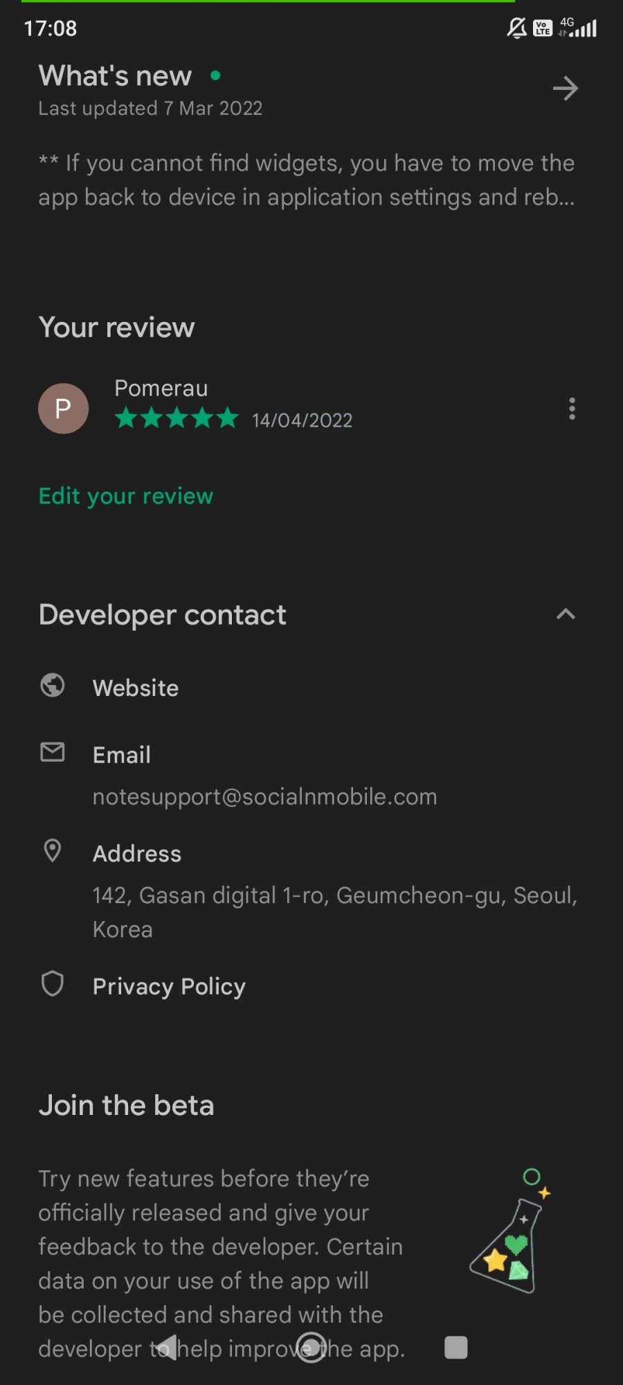

I wasn't even aware that app used Google to backup data. I never use that sort of stuff anyway so I can't help there, sorry. The app will run on Android 12, so perhaps you can use a newer device with the same account, and reinstall the app and get the data that way?

I would try the developer, but if you think you originally started with a different email address, things are unlikely to improve.

IMG_20220722_165335.jpg Screenshot_2022-07-22-17-08-03-007_com.android.vending.jpg
