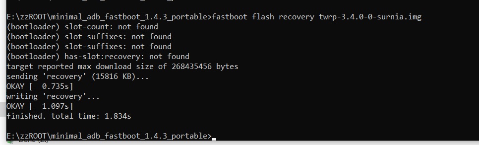

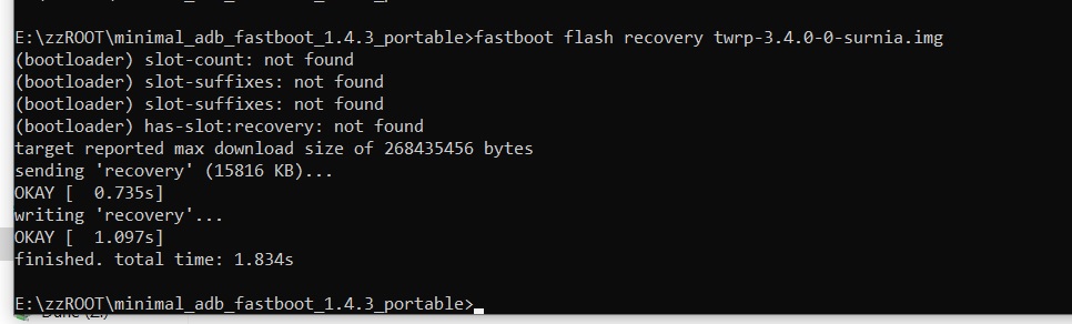

Aha, I installed USB drivers from Motorola and that's helped a bit. My CMD screen (see picture) seems to suggest it went well but my phone is doing absolutely nothing - just sitting on the 'robot with belly open' screen. Any ideas? My twrp.img is in the same folder as Minimal adb and fastboot.
Further info: 'adb devices' brings up a serial number but 'fastboot devices' does nothing. Presumably that means fastboot can't see my phone? How to fix that?
Doing 'fastboot reboot' only resulted in the phone rebooting as normal so clearly there's no TWRP on it despite the earlier CMD message saying 'finished total time 1.834s'...

Code:
fastboot reboot bootloader
..then try your fastboot flashing cmds.
Hello again, bcrichster. Okay, I've kind of gone back to square one. Instead of the portable '15 second ADB installer' I've done a full installation of it. I then replaced the files in ‘ADB’ with new files from the current ‘platform tools’. Happily, both 'adb devices' and 'fastboot devices' can 'see' the phone.
I then ran:
adb reboot bootloader
fastboot flash recovery twrp.img
I had no luck with this and so tried your suggestion of 'fastboot boot twrp.img' and it worked – TWRP appeared on my phone. I didn't want to do anything with it right away so I tapped (if I recall correctly) Reboot/System and my phone is now as it was.
I powered off and then booted into recovery and the standard bootloader screen appeared. I went to Recovery but all I got was the dead robot. Where is TWRP? (When TWRP appeared at the beginning, I didn't elect to install the 'Official TWRP App' – should I have done?)
My thanks!
Hello again, bcrichster. 'fastboot reboot bootloader' results in <waiting for any device>. When that happened with 'adb reboot bootloader' the cure was to install MotorolaDeviceManager.exe which contain the drivers allowing the phone and PC to connect via USB. Are there MORE drivers needed for fastboot? Where would I get them if they're not included with MotorolaDevice Manager?
Is 'fastboot boot twrp.img' an alternative command to 'fastboot flash recovery twrp.img' or additional to it?
I'd have thought that if 'fastboot devices' gives me nothing back (unlike adb devices which gives me the serial of an attached device) then there's no point attempting any command involving fastboot...

Ok.. that means you aren't in any fastboot cmd modes to begin with. Try
Code:
to get where fastboot may work
Hi again. You must have read a post that I later edited. Fastboot HAS worked inasmuch as the commands 'adb reboot bootloader' followed by 'fastboot boot twrp.img' gave me the TWRP screen on my phone. Does that mean TWRP should be INSTALLED on my phone at this stage? Because when I disconnect it and reboot, there's no sign of it...
That cmd I gave allows you to directly boot into TWRP recover, using the TWRP.img itself aside from the device in order to make a backup of stock recovery. Some ppl like it, some don't. But when you install TWRP (at all), ya usually need to also flash Magisk if still on stock OS. If going straight custom ROMs, Magisk is simply an optional superuser mgr at that point. Ok, so if you use @MrJavi 's suggestion of
Code:
, may need use the phone's volume button to select recovery setting and the pwr button to confirm it, should boot right to twrp recovery.. go from there
