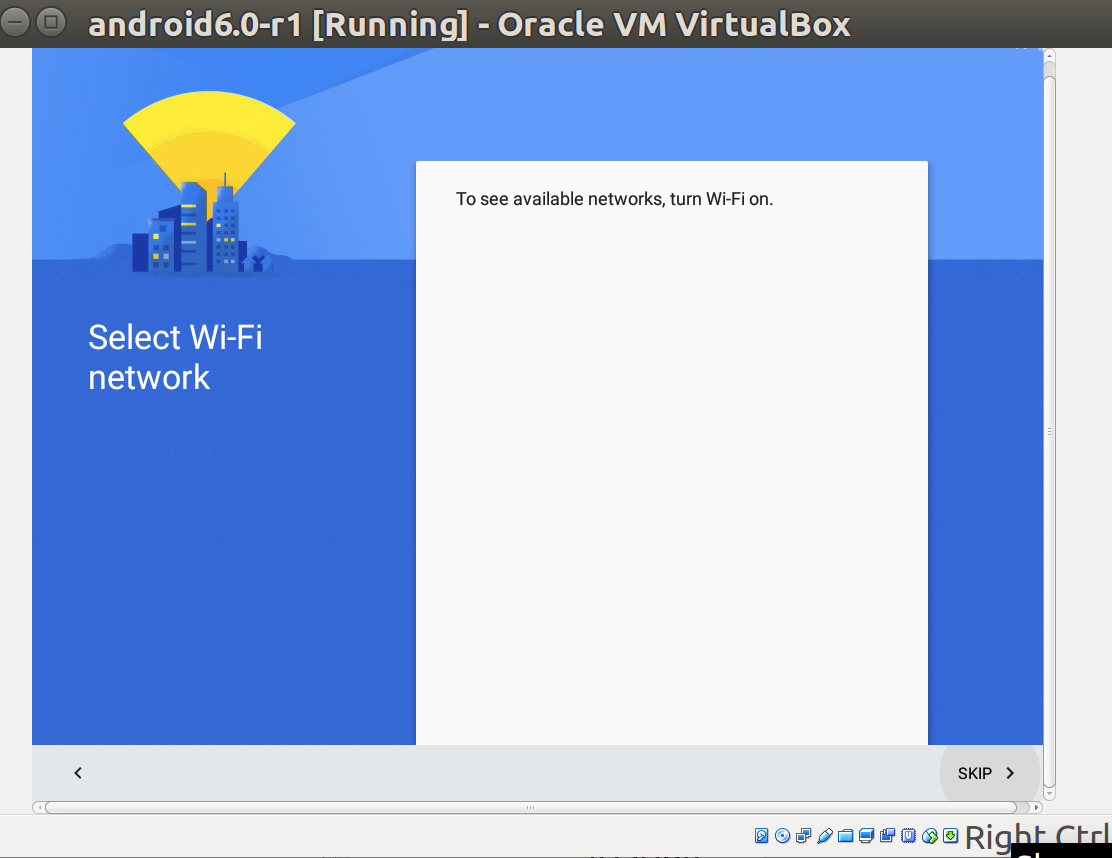

Started Android on VM. After selecting Language it came to following screen (please see attached file)
I couldn't proceed further, no key having function. Mouse pointer didn't work on the screen because VM guest addition haven't been installed.
Advice would be appreciated. Thanks in advance.

Hi,
Thanks for your advice.
1) Mouse doesn't work on Android screen.
2) Bridged Adapter could only work if bridge-utils is installed on Android, the VM. Additionally /etc/network/interfaces on VM must be modified.
TAB key works occasionally
-> Skip setup WiFi
Now I come to following screen;
If you use another Android device, you can quickly copy your current setup to this VirtualBox
( ) Copy your Google Accounts, apps, and data from your other device (highlighted)
( ) No thanks
Now the TAB key is NOT working anymore. I expect selecting "No thanks" to proceed
I'm now searching for the key combination to work on Android screen for overcoming this difficulty.

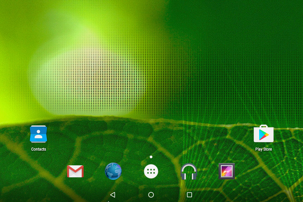

Hi all,
Finally I got Android startup and running.
The trick is on VM Settings:
-> Motherboard
-> Pointing Device: PS/2 Mouse
then the mouse works on Android screen.
I'll get Android installed on VM later.

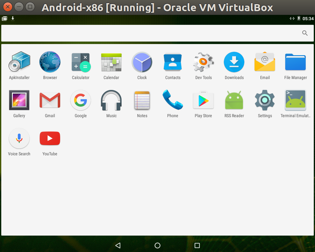

Hi all,
Host Ubuntu 16.04 64bit
VM android-x86_64-6.0-r2
Oracle VirtualBox
Also now I have android-x86_64-6.0-r2 installed on a VM.
But still there is a problem - the mouse pointer is invisible after the mouse working a while on the host. This is frustrating me.
The indicator is on showing the host mouse pointer is captured by the guest. But the mouse pointer is invisible on the guest. I have to reboot the guest to get it back.
I'm still working to figure out a solution.
Any advice?
