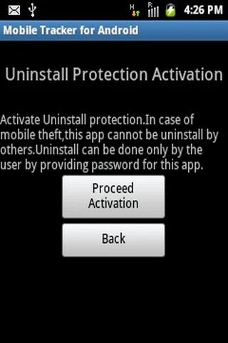

The app seems to have an "uninstall protection" function. Try going into the app to disable that protection - looks like you'll need the password that was entered when you enabled the protection.
https://lh4.ggpht.com/etee5abSdpHjEYtbchUt1v0o2w2LTl_CWQVj-sdgILgCfkJuB-ElSnmtXdWXzbrOTQBj=h900-rw
yeah, the app did have uninstall protection. I deactivated it by opening the app, going to options and providing the password to deactivate the protection. It now says 'uninstall protection deactivated'. However, the app continues to remain listed and checkmarked in the device administrator list and the uninstall button remains greyed out.
