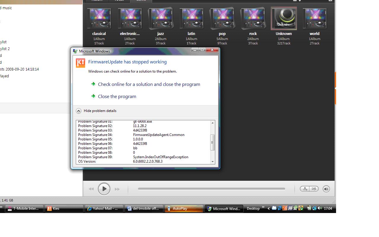

As per the instruction book downloaded the Kies software from the Samsung website to my Microsoft Vista PC. When connecting the telephone it said new firmware was available and so I pushed the update button (see zip file).
It showed an increasing percentage complete and then at the end said "FirmwareUpdate has stopped working" on the PC. RePlugged phone in again to PC and pushed update and with 5 seconds message appeared on PC screen (see JPG file).
So uninstalled Kies, switched off Norton virus checker, reloaded Kies and exactly same sequence of error messages as before.
