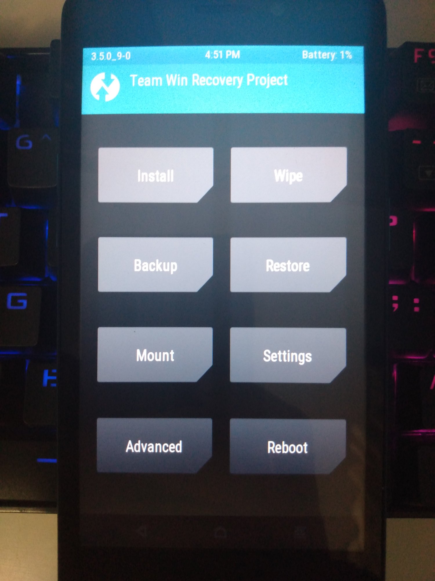

Team Win Recovery Project 3.x, or twrp3 for short, is a custom recovery built with ease of use and customization in mind. Its a fully touch driven user interface no more volume rocker or power buttons to mash. The GUI is also fully XML driven and completely theme-able. You can change just about every aspect of the look and feel.
Working:
SD card access
Flashing
Brightness
Touch Screen
Everything else...

Installation
As this device is quite locked down from the factory, the installation process is a bit long, but is easy once you get used to it.
You will need:
- QFIL Flash Tool
- ADB Console (Platform Tools) https://developer.android.com/studio/releases/platform-tools
- "Files for QFIL" ZIP file (Check attachment)
- A PC
Unlock the bootloader first: https://androidforums.com/threads/how-to-unlock-the-bootloader-of-the-zte-avid-plus-z828.1324697/
- Download the "Files for QFIL" ZIP file and extract it to the desktop
- Boot into Factory Test Mode (FTM) by pressing VOL- and POWER
- Connect your Avid Plus to a PC
- Using ADB commands, type "adb reboot edl"
- Open QFIL
- Select "Flat Build"
- Click on "Load XML" and select the Patch0.xml and Rawprogram0.xml files from the desktop.
- For the Programmer, click "Browse" and select the firehose called prog_emmc_firehose_8909.mbn
- Rename the downloaded recovery to recovery.img, and make sure it is in the same folder as the Patch0 and other QFIL files.
- Click on download.
- Once done, remove and put back the battery and boot to TWRP using VOL+ and POWER
