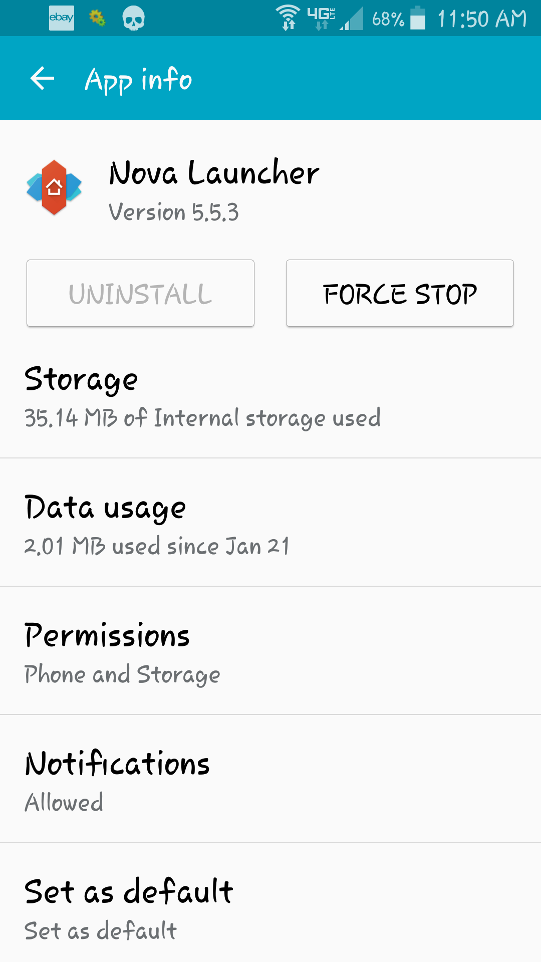

Went to the app information page and found that the "Uninstall" option was also not available.

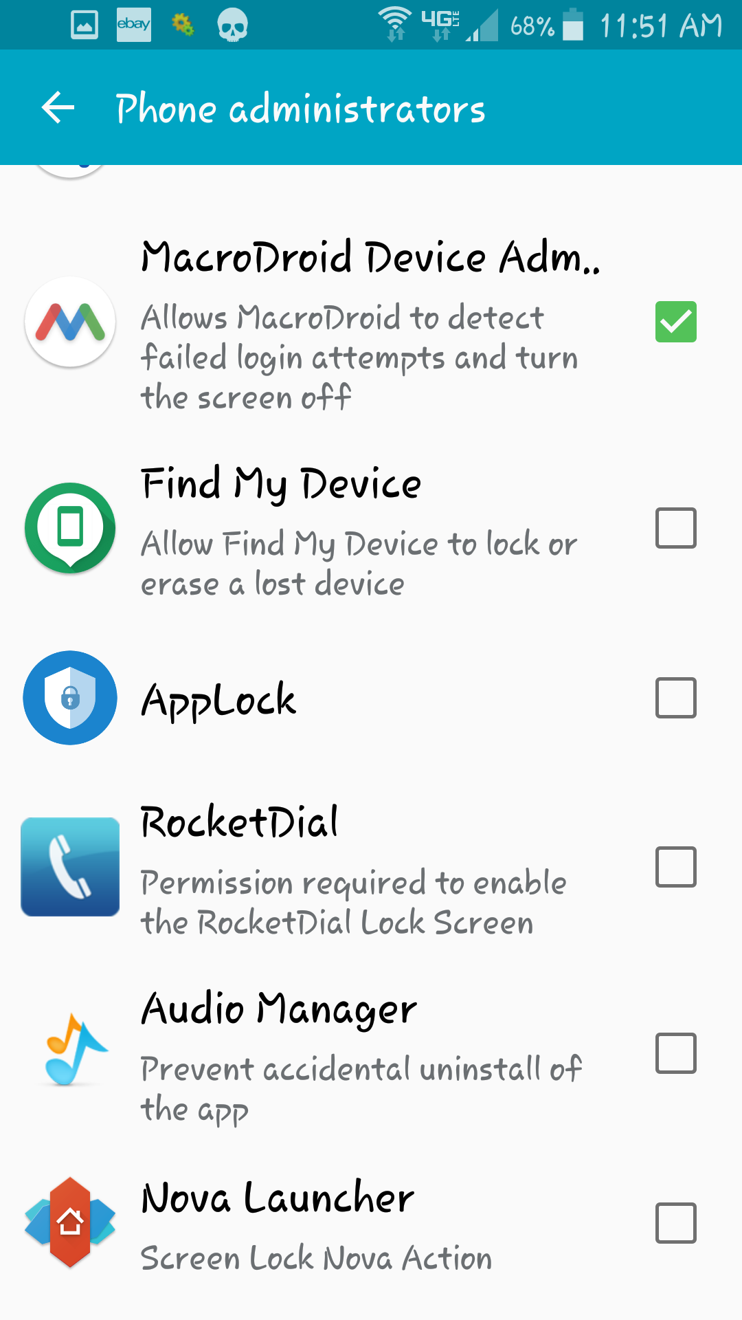

Checked to see if I had made Nova a Phone Administrator...
Negative.

It's because Nova is set as default.
I just checked and uninstall was greyed out for me as well (Nova 5.5.3) until I changed the default launcher to Apex. Then I could uninstall Nova (but I didn't because I don't wanna ;) )

Uncheck that "macro droid"..
