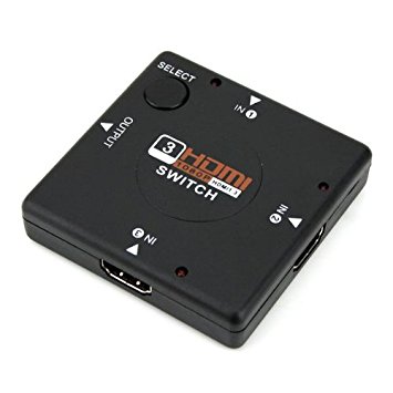

If the Android TV box works fine with nothing else attached to the TV and you must have all your devices plugged in to the TV at the same time, then you may want to consider a cheap HDMI hub.
I use a hub because the TV in my classroom only has two HDMI sockets and I need more...
This is what mine looks like...

iv taken ur advice and bought a hdmi splitter. does it matter which port i connect the output too? my name has stb. dvi, arc and hdmi
i got it from amazon but it didnt really come with a user manual.
its still switching off my tv. i have output connect to the stb slot. sky box into input1, ps4 in input2 and android box in imput3. within 2 mins of switching to android box my tv went off
