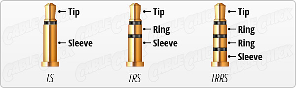

How many conductor rings are on the end of the headphones / aux cords that you're using? The phone expects four conductors (TRRS):
If the cable connection has less than four conductors then you sometimes wind up with shorted signals on the phone side, and those shorts get interpreted as if you were pressing buttons on an inline remote.
I do not currently have access to the other connectors I was using, but the current one causing the issue is TRS. Looking at my other headphones that haven't been causing me issues, they both TRRS... this is likely the issue. Thank you!
Yep, that'll do it!
I think that I had seen some cheap TRS -> TRRS adapters somewhere that would probably resolve this issue without requiring a different set of headphones.
