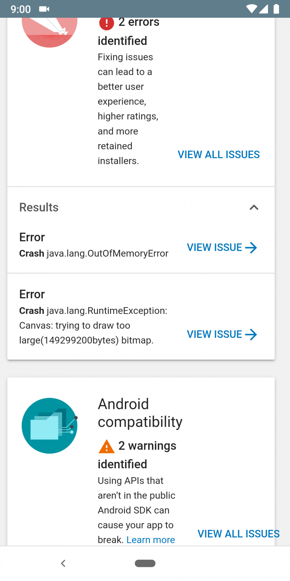

I built a video game and it works perfectly on my pixel 3 phone but if I put it on any other phone such as my SamSung Galaxy S7 it crashes. I compile it at min sdk 14 and target sdk 29. I suspect its a hardware issue but I've never seen anything like it here is my gradle configuration. Can anybody spot the issue or help me make it compatible more than just my pixel 3 phone?

Is it possible for you to retrieve the crash log from the device? A stack trace would provide valuable diagnostic information about the cause of the app crash.
Alternatively, if you connect the Samsung to your computer, and run the app directlly from Android Studio on the connected device, the stack trace should be immediately visible in the Logcat.

2019-06-20 08:13:38.044 26403-26403/com.calmchesscomputers.game1 E/AndroidRuntime: FATAL EXCEPTION: main
    Process: com.calmchesscomputers.game1, PID: 26403
    java.lang.RuntimeException: Canvas: trying to draw too large(149299200bytes) bitmap.

It's a runtime error.......there aren't any apparent errors in Logcat. I don't read the stack trace very well anything you can spot would be greatly appreciated.
I did a Google pre launch report it works on 14 devices and crashed on 2 one was an out of memory error and 1 was bitmap too large....do I just have to put up with it crashing on some devices or is there something I can do to make it work on all devices?
Screen shot crash report
I figured this out I had to set the min and max widths on my constraint layout and set the aspect ratios of all my screen objects/images. Then it worked on other devices. As far as the memory problem goes there is nothing I can do about that if my users have a phone with minimal ram installed. .......thanks for the focus session guys. Make sure you use the play stores analytics stuff.....highly useful to figure out run time errors!
The relevant part of the stack trace, and what caused the fatal exception is
Some suggestions here about your specific problem with large bitmaps -
https://stackoverflow.com/questions/40835514/android-studio-canvas-drawing-too-large-bitmap
