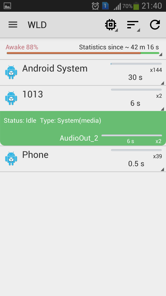

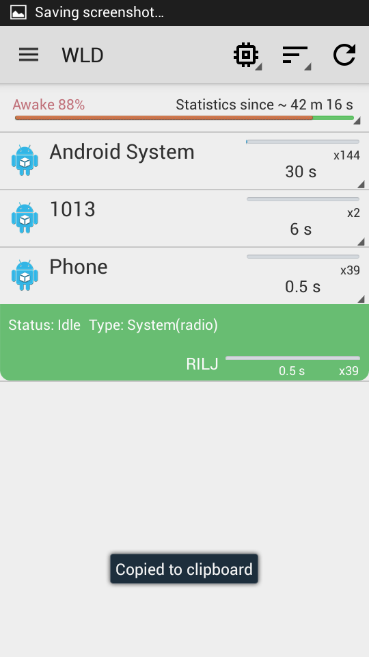

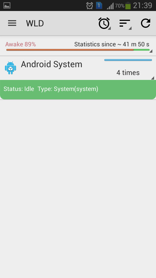

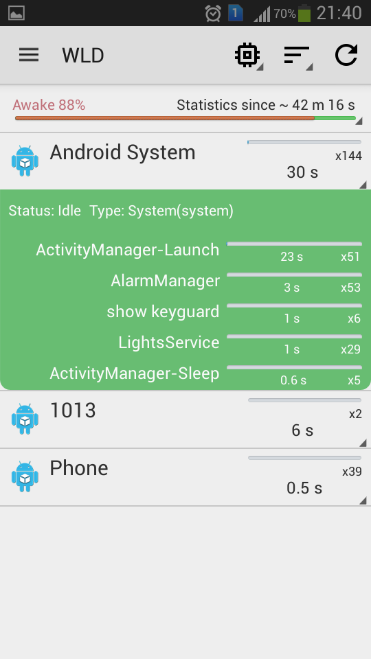

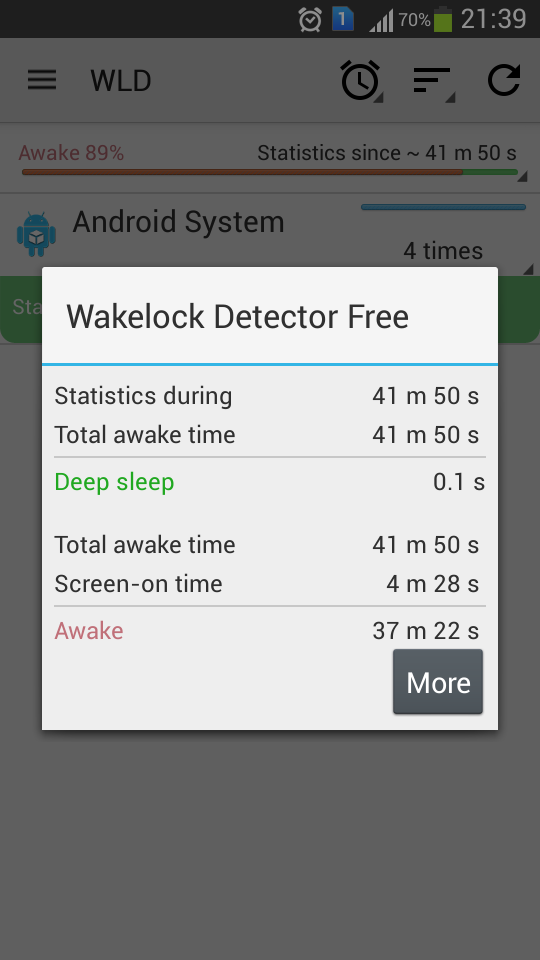

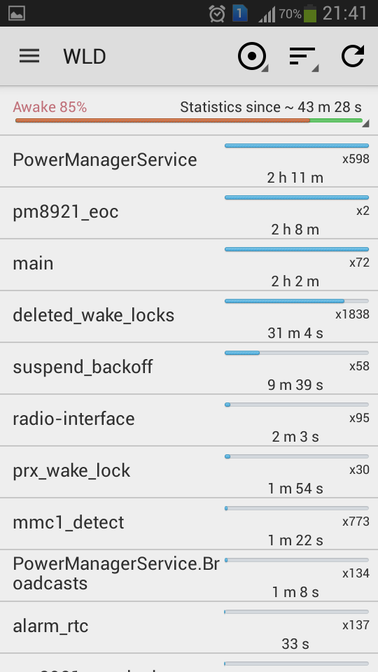

Recently I've been having mysterious battery drains and I've been fixing it by simply restarting my phone, then the issue kept coming back after a while of using mobile. So I thought I'll create a thread and ask experienced users.
So the issue is this, my phone has been working perfectly fine until I've charged it to 77%, then I unplugged charger and left it alone, no apps running, no wifi or data, everything turned off and RAM cleaned. I came back after around 30 minutes and I notice it's down to 70%, the WLD shows that it's been awake for the entire time, only slept for 0.1 seconds.
It's rooted with KingoRoot by the way, stock rom, no suspicious apps. The apps I'm using are: Android Assistant, CatLog, Steam, Orlygift, Package Disabler, SAS: Zombie Assault 3, System App Safe Remover and Wakelock Detector Free.
Edit: Uploaded screenshots.

Can the wakelock detector give you details about "main" and "pm8921_eoc"? They both are very suspicious. If you could see what app do they belong to, I would uninstall that app or disable or freeze it.
The most important thing is to find the faulty app and to remove it. If wakelock detector can't do it then try Gsam battery monitor. That app uses to be able to identify the apps owning the processes that waste the battery.

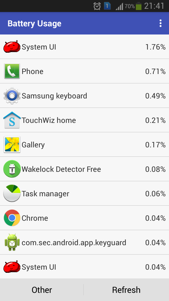

Thanks for the reply, WLD doesn't really give any info about pm8921_eoc and main.
As of battery stats, there's nothing suspicious, Android System is taking 19.4% battery and that's the most.

Definitively you must install GSam battery monitor. That application will give you the ranking of the most battery taking processes since the last charge or since the moment you want if you choose it. When you see the processes on the top on the list, you push on them and it leads you to the app they belong to. Then you uninstall it and you get rid of the damned battery consumption.

The most priority thing you have to deal with is finding the process that is finding the app responsible for that wakelocks. I don't think you have to worry about your battery percentage or charging time.
Unfortunately your screenshots don't show enough information. Perhaps you can Google the name of the suspicious process to see if it is related with a specific app. If you find it, uninstall the app.
