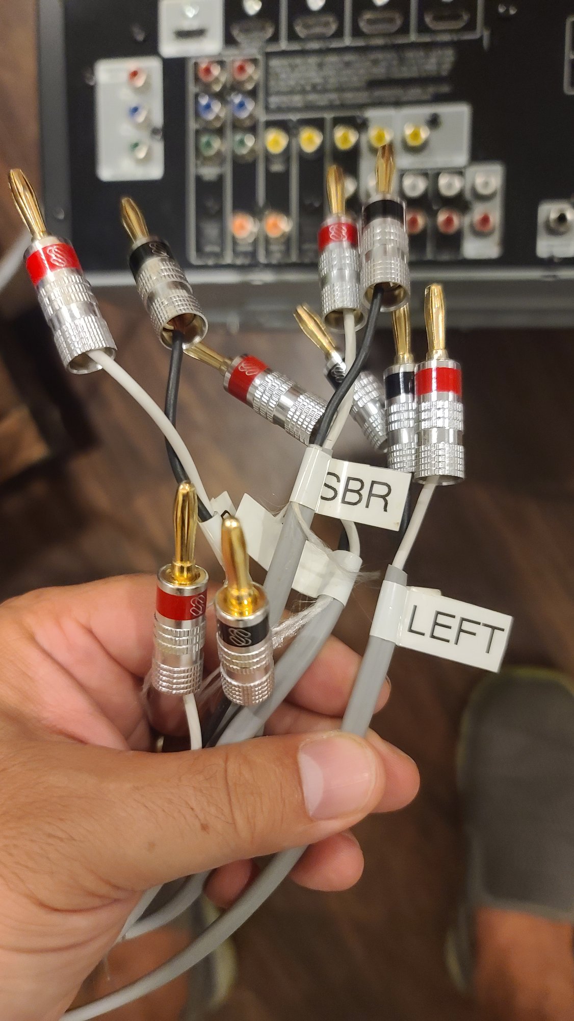

Home theater newb trying to set up a wired home theater system left behind from a previous home owner.
There is a closet with these wires:
Seems like left, right, center, surrounded left, surround right, surround back left, surround back right.
This corresponds with receptacles around the room that seem to connect with regular speaker wire.
However, is there a recommended receiver I should be using with this connection/setup? My current receiver would require me to take these caps off, but who knows, maybe they are intended to be removed? (They have star like tips).
I am excited to finally get this thing working!

Those are banana plugs, used for speaker connections on most receivers.
Most likely whatever receiver you buy will have the mating jacks/binding posts and you can just plug them in, if not the plug can be removed by grabbing the two knurled sections and unscrewing leaving just the wire.
This was the answer. Thanks!
Was able to expose the wire to connect directly to the receiver. Now onto new problems (like not being able to find the video source). So much weird stuff up in the ceiling!
