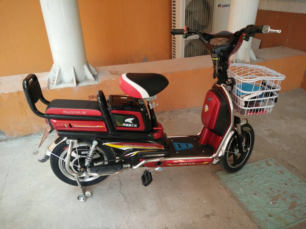

The vehicle I drive is 48V, I don't even attempt to try and charge my phone from it.
AFAICT a Griffin Powerjolt is described as a "car charger", which means likely it's rated for 12V, and NOT 24V. Be very careful you don't over-voltage the thing. With a 24V to 12V step-down it might be OK.
48v wow. What you driving
I don't even attempt to connect my phone to it.
Definitely 48V, that's what's in the instructions and stamped on the charger. 4V, I don't think would go anywhere....LOL.
"富士达电动车48v"
No Tesla of course, because I'm not in the United States. Although that probably has a 12V cigar lighter outlet.
