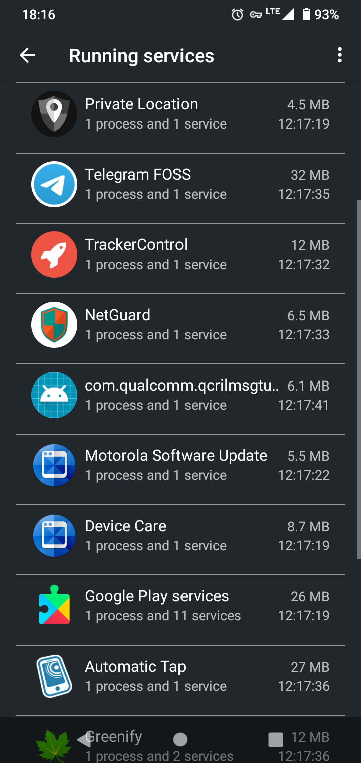

Open Developers Options, and inside there you can find Running Services.
This will give you a breakdown of what is running and how much memory each uses.
Any of your own apps may be just as large of an issue, although things like Google Play Services and automatic type apps are usually real pigs.
Here is a sample of mine on this device.
You can see that apps that run in the background are the largest users.
(Although I have Google Play Services blocked from the web, so it is not using much- but itvis still second highest user!)
Things like Telegram are going to use because they must constantly be running in order for alerts to work and to keep updated with current information.
If I turn off the ability for it to run constantly, then when I open the app it takes time for messages and new items to download since the last time it was open.
The Tracker Control and NetGuard run always because they have a quick setting tile that I can use to turn them on and off.
My VPN is the same way.
Now that you have me thinking, I might remove those quick settings so that when I am not using them they are not running for no real reason.
