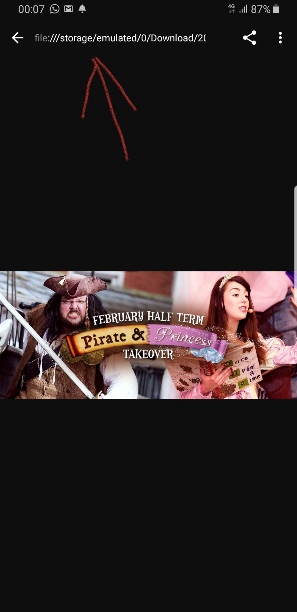

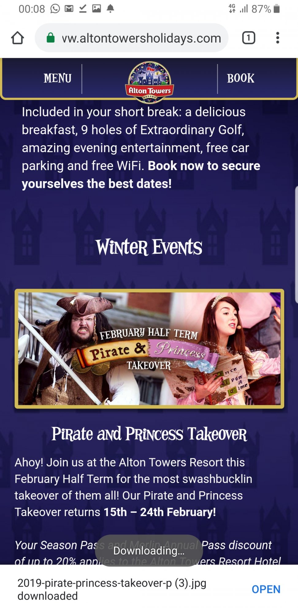

Interesting, thanks. I'm using Google Chrome to download images and I do have a file browser installed.
Ok, so when you download an image in Chrome a popup appears stating where the images are saved.
Normally:
/storage/emulated/0/Downloaded
Download an image in Chrome and when the popup appears at the bottom of the screen select Open.
Once open please take a screen shot and post it here using the Upload a files option when posting. (Power button and volume down together to take a screen shot)
This way we can see where the images are being saved too.
See attachments..
Photos from internet. This would depend on how you downloaded them because Google and Chrome suck. They store the photos in a weird location that you can only access from within them, and the gallery can't see them. You have to enable some stuff in the settings for them to save to gallery. I just stopped bothering and stopped using Chrome and started using Samsung Internet, which is actually better than Chrome since it is able to see Chrome Bookmarks, has a dark mode, has ad blocking extensions, has anti-tracking extensions, a password protected secret mode(incognito), and a few other features Chrome lacks.
