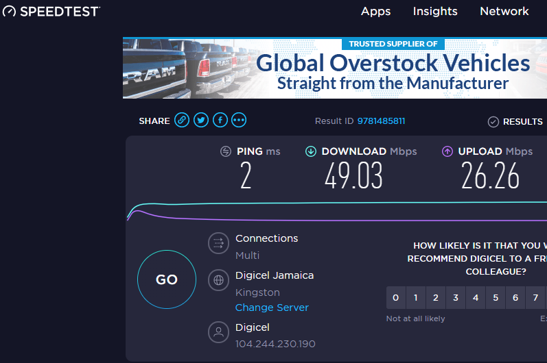

I have a 50Mbps connection from my provider. It's fast and reliable for the most part. The desktop computer is connected to the router through an Ethernet cable and when I do a speed test on the desktop using speedtest.net I get this result:
Result ID
9781485811
PING ms
2
DOWNLOAD Mbps
49.03
UPLOAD Mbps
26.26
Downloading files via the desktop computer on average yields a download speed of 5MBps which is not the 6.25MBps that I should be getting but very good nevertheless. We all know that it's hard to achieve the full amount of Megabytes when downloading due to factors like network traffic etc. but if it's close to what you should be getting it can be considered excellent.
