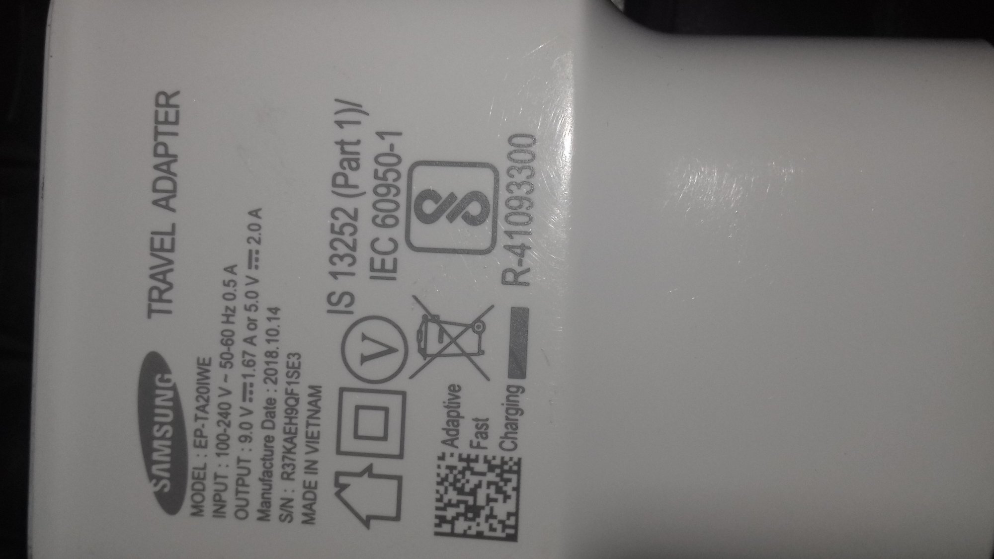

Should i check the newly bought charger at the service centre .it is brand new and bought it two months back from samsung service centre

Hi, Unforgiven, \
Your clue is correct. i just took in to service centre and asked to recheck the charger. with the usb cable. He checked with other phone, and found that there is problem in new usb cable.. He asked me to wait for a few days for replacement of charger with cable.
I said, i approached so many forums and the latest advice i got it , to change my wiring all together.,I also told him to check the output amperage continuously for few minutes. He says that voltage is not an issue but the device has some issues.
i am waiting for the replacement. thanks for unforgiven to touch upon fluctuation in amperage
