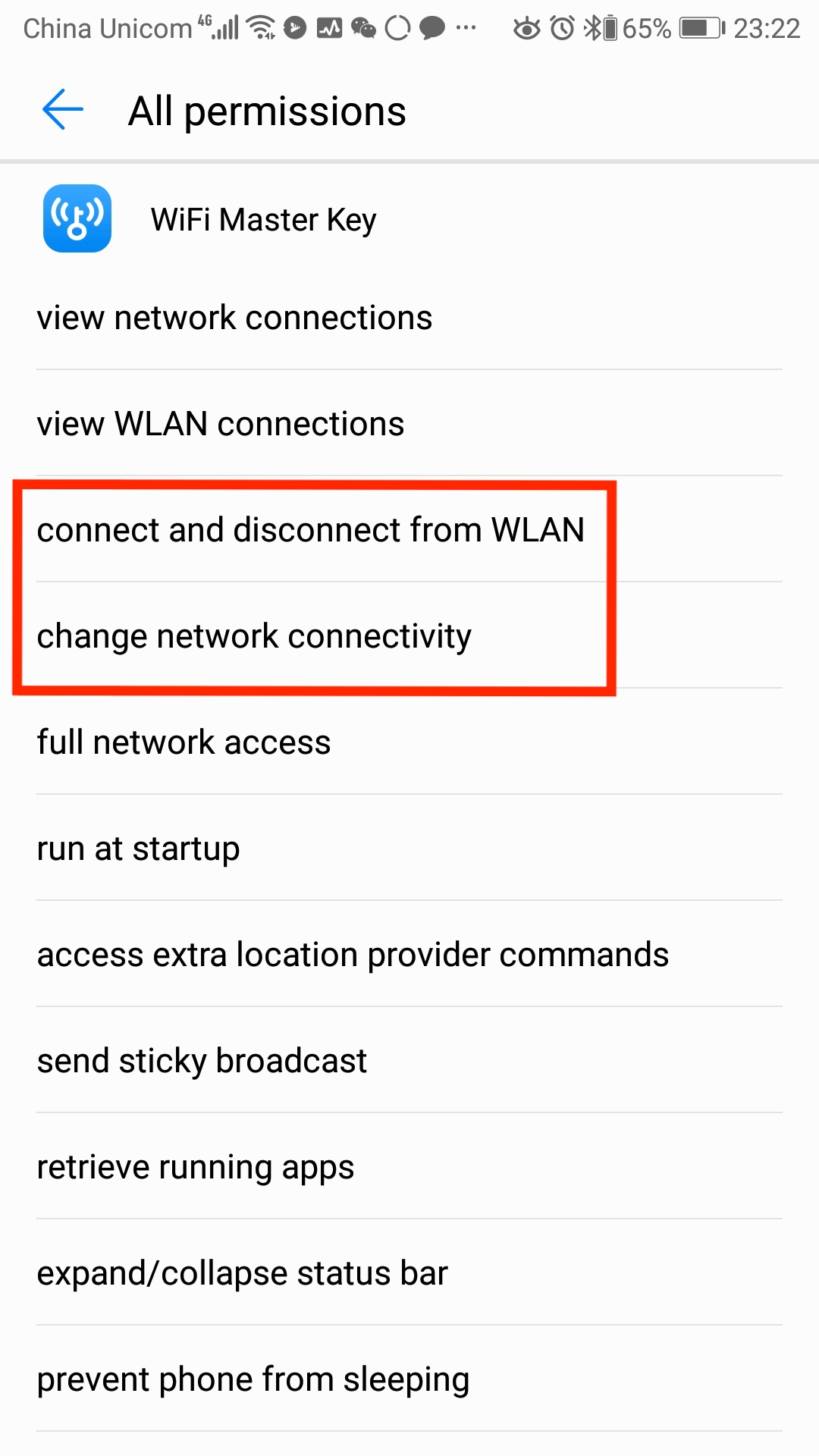

There is a permission where apps can control the WiFi and turn it on if required.
e.g. this is an app on my Huawei Mate 10 called "WiFi Master Key", and that can turn the WiFi on if it's off. LG V30 could be different, I don't know this device.
No such permission ("modify system settings"), went through my apps permissions one by one, couldn't find any evidence to anything that may do that.
