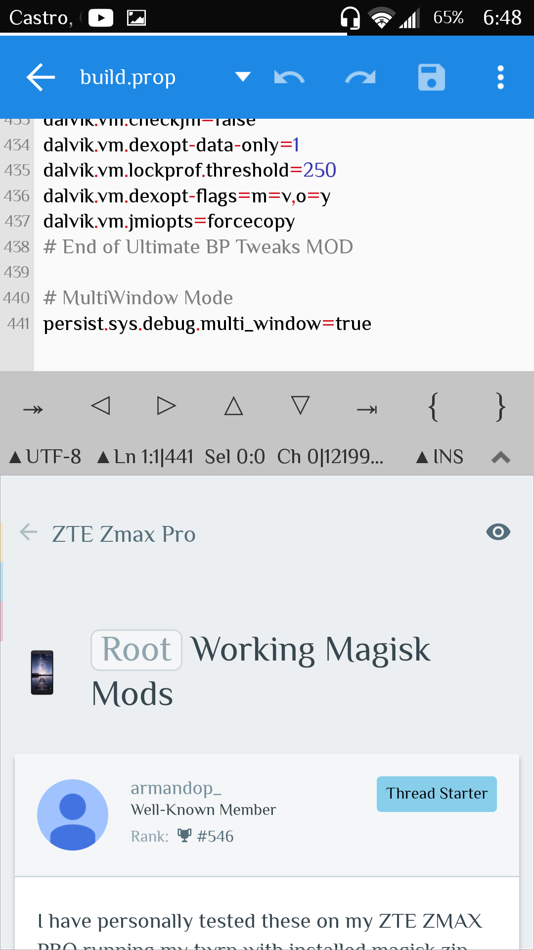

Another little update, if you add
"persist.sys.debug.multi_window=true"
to the build.prop, multi window mode is enabled. To choose the apps just press the recent apps button & there should be options on the right corner.
