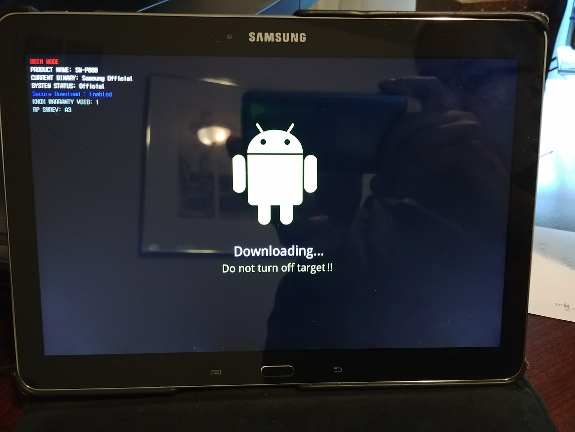

It's power off, then press and hold home + volume DOWN + power until you get the warning screen, and then volume up to confirm. That puts you into download mode with the device status in the upper left.
Then you press and hold the power button until it reboots to get out of this screen.
As you can see my Knox=1 which means I'm a bad boy. ;)

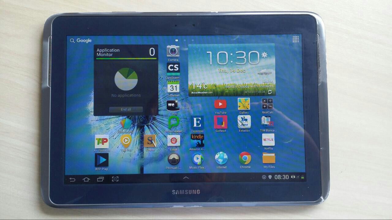

My tablet is the original Note 10.1, manufactured 2013 (see below). There isn't KNOX on it as far as I can learn. Also, there's no HOME button on it.
What I found for this model is to turn off power then press and hold Volume UP + power until the logo appears, then release power only. When the recovery menu appears release the volume up button.
The rest should be the same ... volume buttons scroll and power selects. Clear your cache but do not factory reset. Then reboot.
For download mode, its probably the same thing only using the Volume DOWN + power. Not sure if it will tell you if the device has been modified there. It's worth a look.
