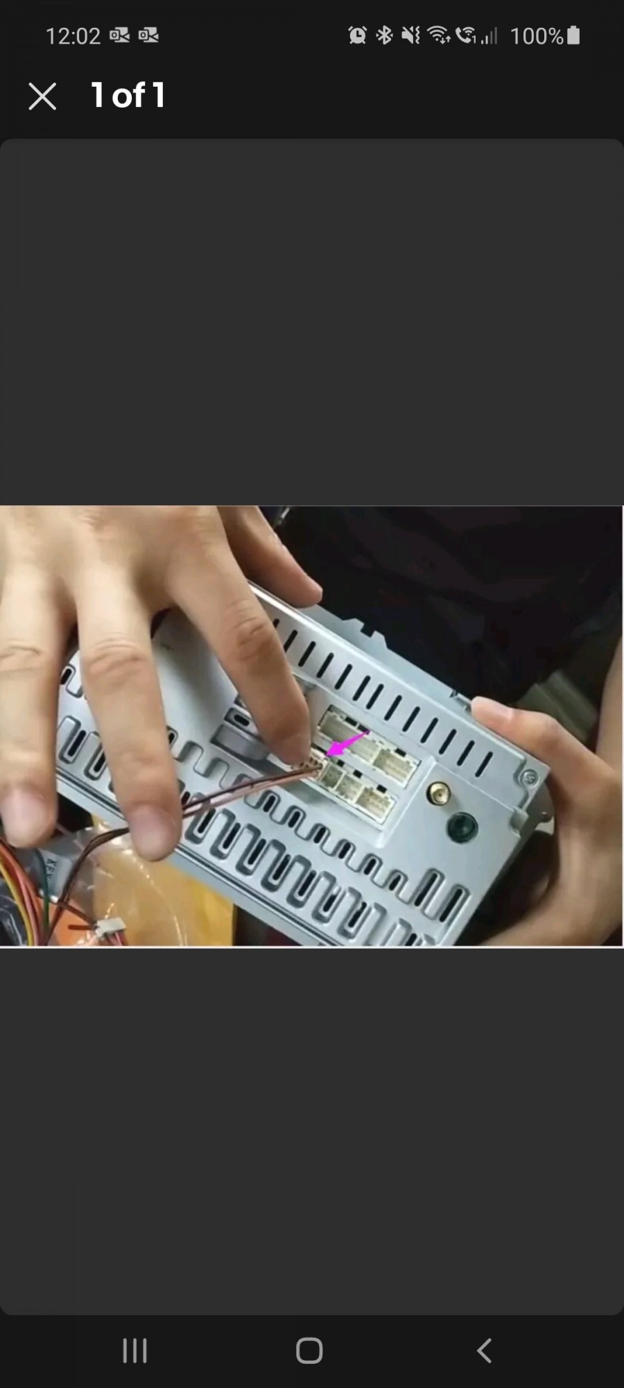

They have also said this:
I am sorry for the inconvenience caused.Please don't worry, we will try our best to help you.
could you please remove this cable,check the radio can be turn on or not, and please send me the canbus photo , may be it's the canbus problem.

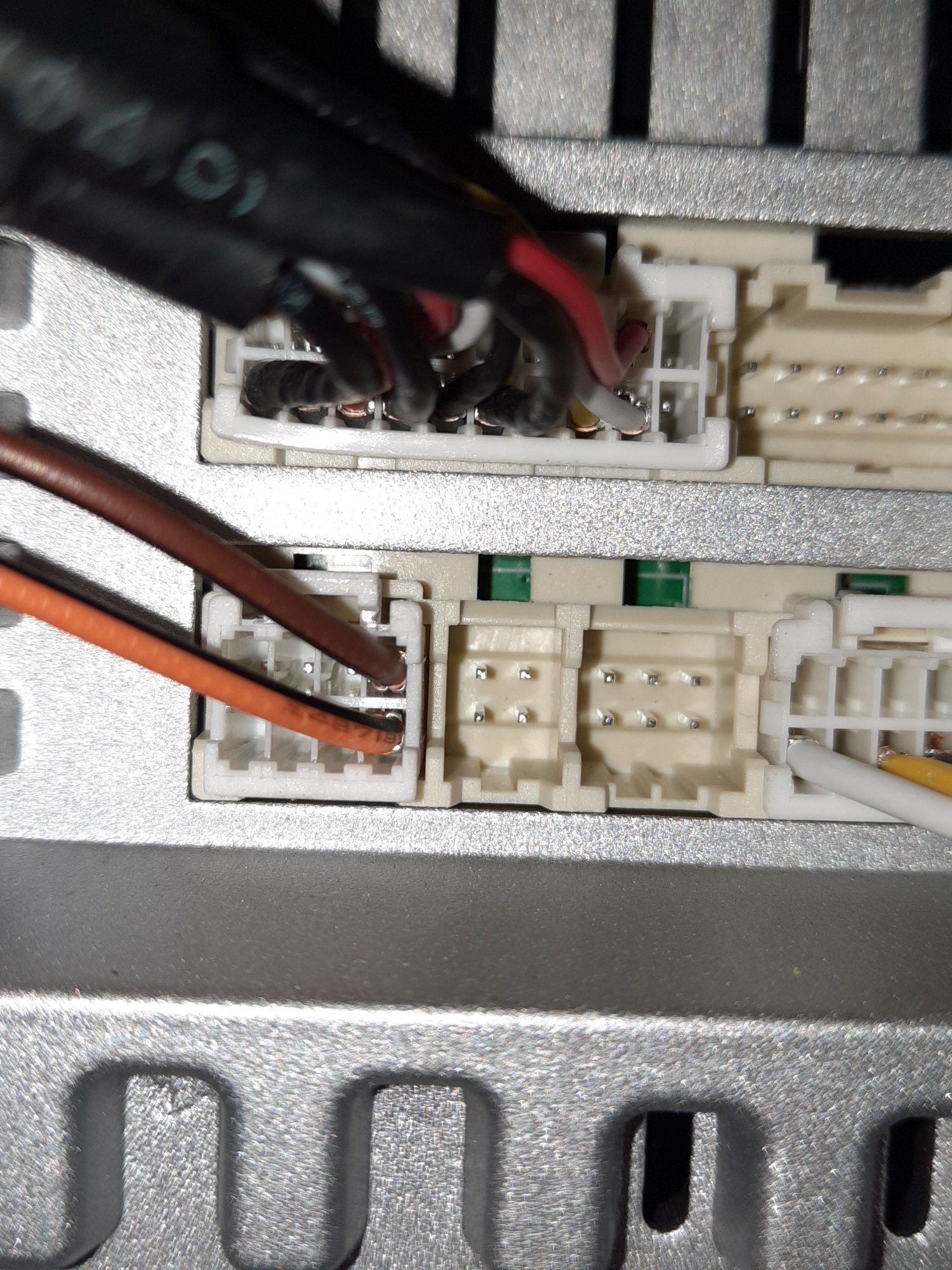

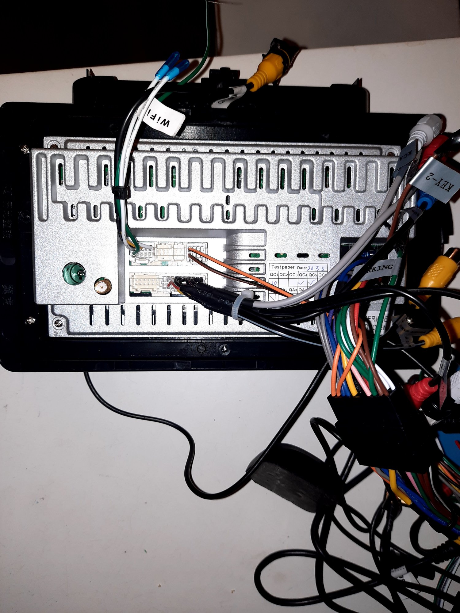

Attached are images of the canbas they requested
I don't have any way of testing the radio. I'd have to take it to a garage and they will charge.
Is there a psu i could get that would let me power up the unit without me having to install it in the car?
I don't think so, not unless you can get hold of a workshop CANbus testing rig. Having said that, I've never touched anything CANbus myself(I haven't owned a car in 15 years), I only know what it is and have seen online.
I think your best move is to get them to replace it, and try a new one.
