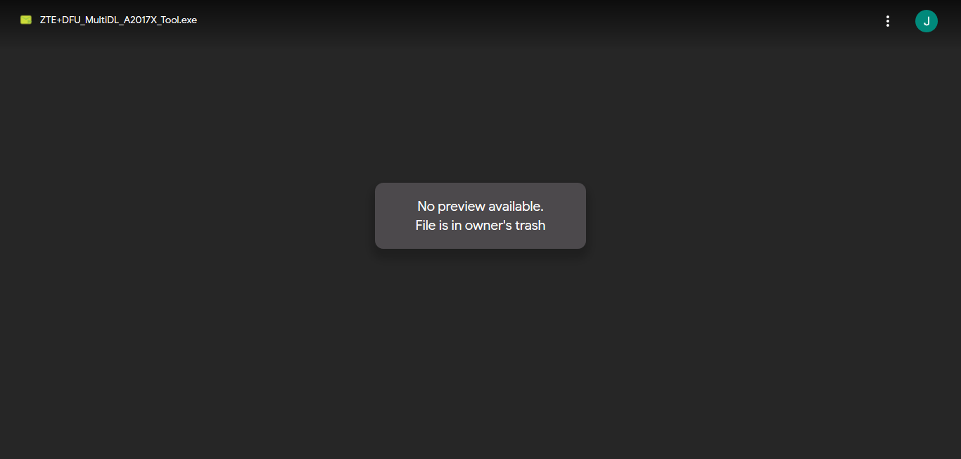

First, download this to to put the phone from dfu to edl mode : https://drive.google.com/open?id=1jC_M1I5QhCLZE-uMPAkaueyRi7e9m-sq

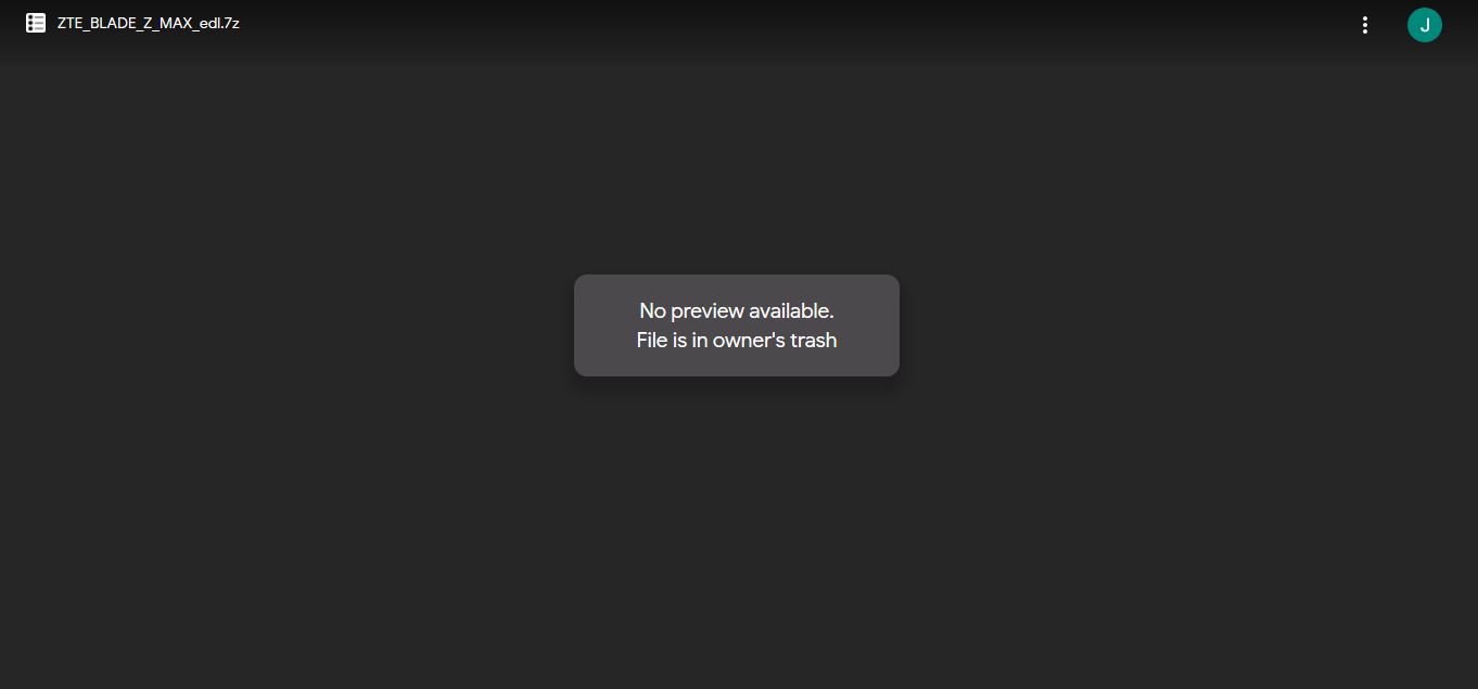

Second, download this tool to flash boot and recovery imgs in edl the tool need to be extracted it very important : https://forum.xda-developers.com/zte-blade/general/zte-blade-z-max-edl-tool-flash-backup-t3902421

the first two downloads do not work
Yes, I know this is and old thread but if anyone maybe has these files and can send them to me?
