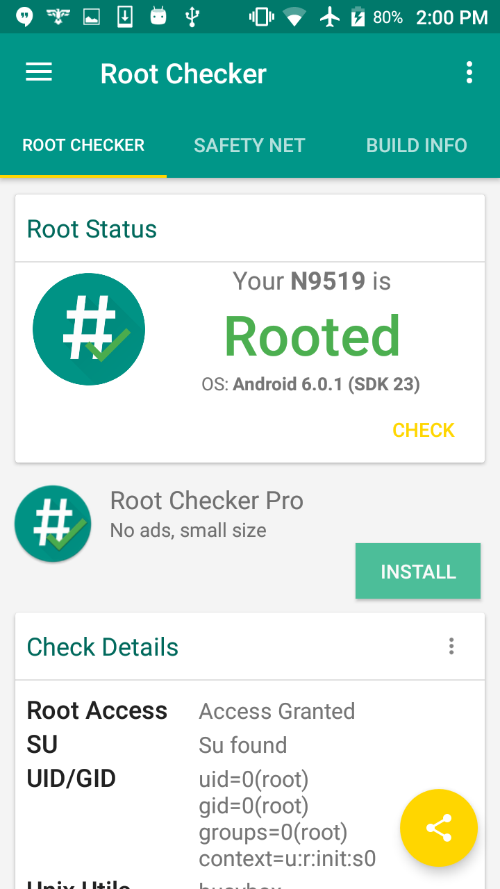

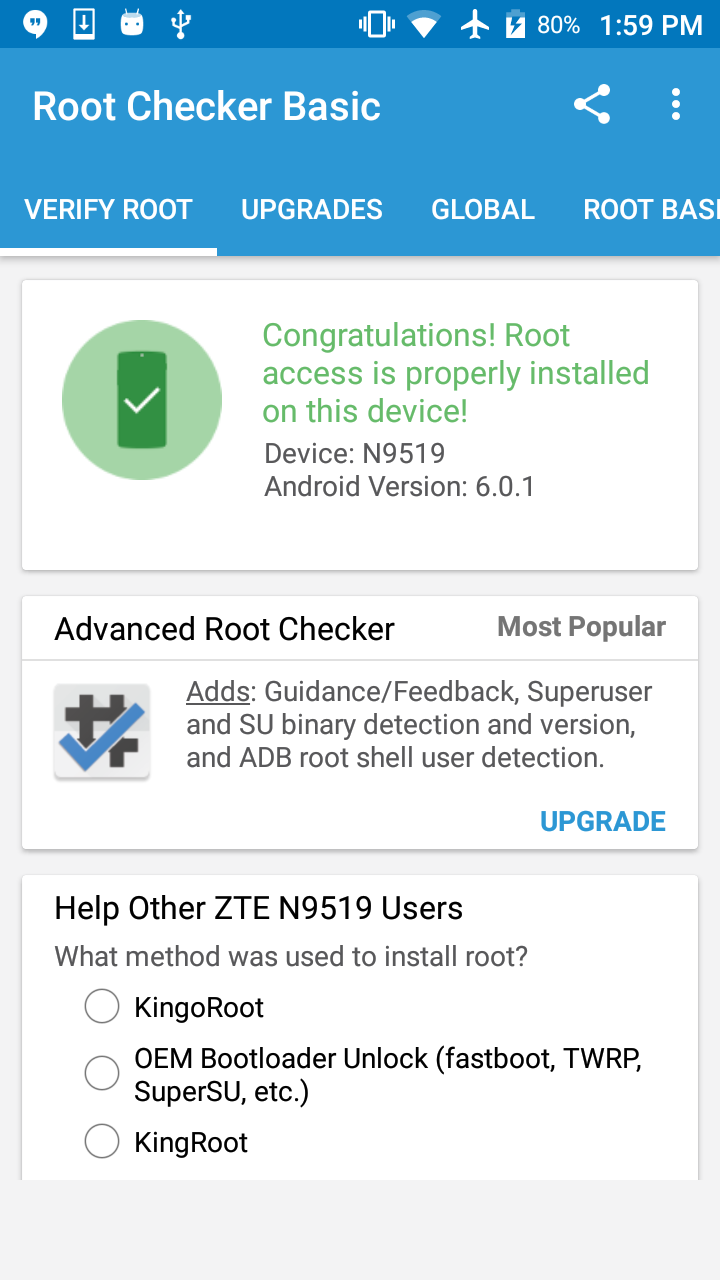

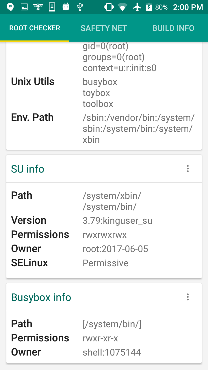

that is my device i had to modify his guide for it to work on the warp 7 i can try fix his link but all the info u need is there i can record a video if u like
