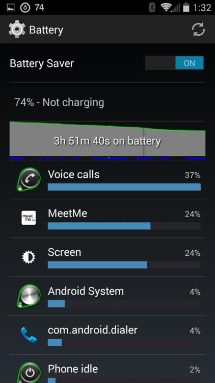

You may want to go to settings / battery usage. Take a screen shot of that screen, then tap the graph and take a screen shot of that screen and post them. It may show something else.

Global and LTE/GSM/UMTS seem to work about the same.. I'm 30 miles from Cincinnati atm Db is GSM -99dbm. It does however dip to -105dbm constantly
Phone call was 10ish minutes long

What is "Meet Me"? If you uninstall that app, do battery stats get better? Did you ever get a screenshot of the screen you get when you tap on the graph in battery stats? ( It's probably better to do that after the phone has been running for a few hours at least.)

Yes screenshot is attached a few posts up... meetme is a social networing app, it's about half the size of the facebook app I think... I sure hope youre right about signal strength... it was doing this too w/the ATT sim in my ST starter kit... maybe I just got a bad batch of sim cards possibly bc ever since I put in the tmobile sim in it (had to), my data is sketchy, cant text over 4g, never blue signal bars, weaker coverage

Yes, but go back into that screen and tap the graph. That will bring up another screen that shows signal bars, awake bars, WiFi bars, etc. That would also be helpful to look at to see if there is an app or service that is holding the phone awake while the screen is off, for example.
Based on the screenshot you posted, it's also using a lot of battery - second on the list above the display, which is unusual. That's why I'm wondering if the drain would be less if you uninstall for a day or so.
