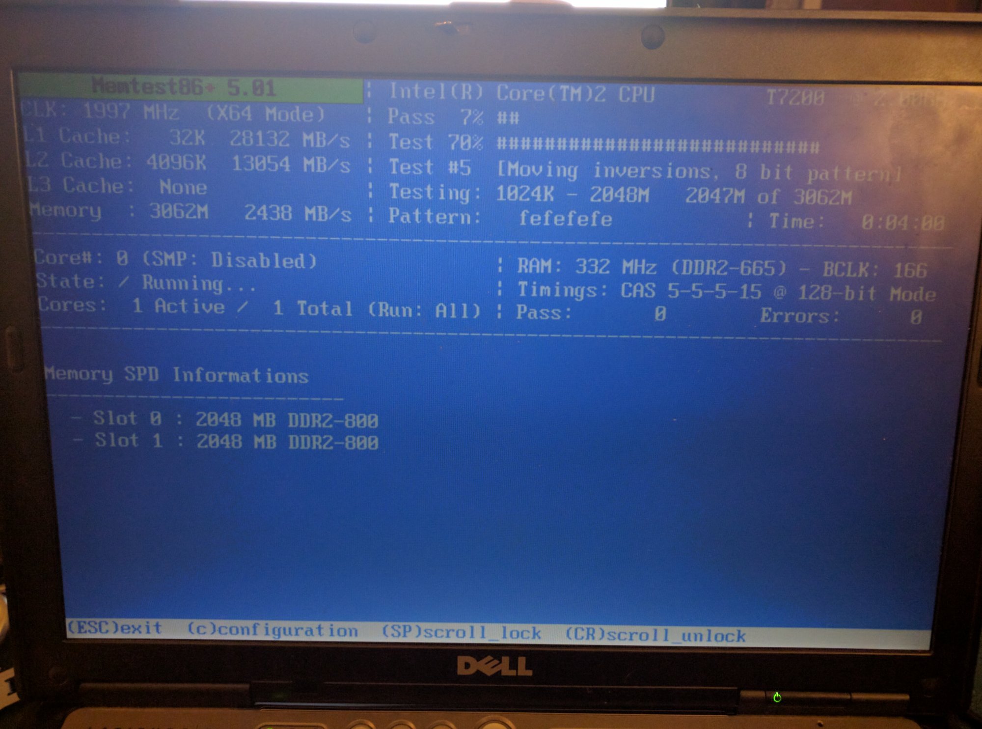

Have you tested the RAM? Is the CPU overheating?
RAM issues usually don't cause shutdown, but overheating (or poor main battery life) do.
Though I do agree with Kate that the RAM should be tested.

@Dngrsone @kate @svim @psionandy I'm sorry, I had some family time. I have tried everything suggested. Removed the battery, RAM tested. I can't even set the correct time and date in BIOS without this password. It is etched into the Motherboard and is shipped from the factory with this password. It is a laptop so there is no password jumper or master CMOS reset. The overheating cpu is something I haven't considered.

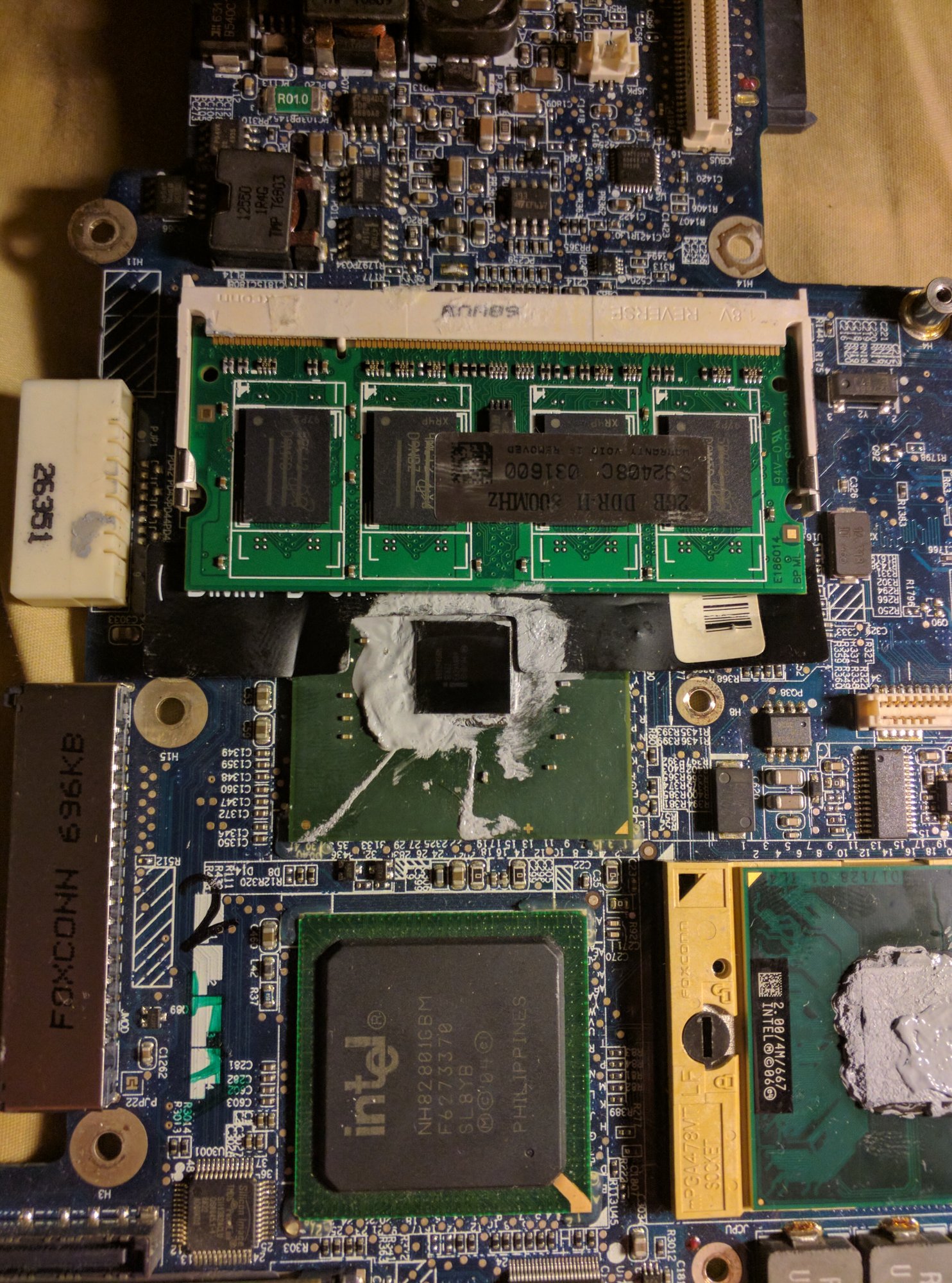

Update, there are two dimm slots. One excessable from a hatch on the bottom , the other is on the reverse, under the keyboard. I removed the RAM from the lower slot and it booted into gparted. I think I have a bad slot, and 2 GB RAM is not going to cut it.

Culprit:
Yes, that is the GPU. 1/4 " from the RAM slot.The second slot is directly beneath the first. It gets a little warm right there.
Someone must of thought of that 5 minutes before lunch break. Great craftsmanship. Would have been a decent enough machine for a six year old to play Mine craft on. . . . or watch his favorite show:(

Culprit:
Yes, that is the gpu. 1/4 " from the RAM slot.The second slot is directly beneath the first. It gets a little warm right there.
Thank you all for the help. Guess the locked BIOS was just the beginning of the problem.
Intel. So it's not one of the faulty Nvidia Geforce M ones then. I remember at the time manufacturers like Dell, Sony and Apple did extend the warranty to cover ones that failed, after the original warranty expired. More details here with a Sony Vaio...

It is definitely a thermal issue. I thought it was a bad RAM stick. Replaced it and got Windows 7 90% installed. Even with the cooling pad, after running for a while it just shuts down. I think there is a BIOS setting that controls this. BIOS is A04 current is A10. I'm going to see if I can't flash a newer version.
I ran every diagnostic. Everything passed. Still a bit befuddled.
