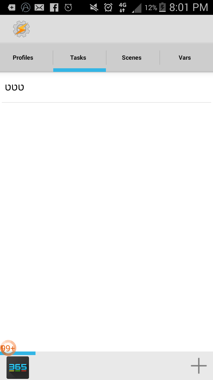

good morining i made task that will opreate in a part of the days of the month in the same hour but the task dont work i mean the date and time become green but the app dont work on the given time i set for her can u help me i am adding pictures

Your first image is the Task selection page.
Long press on the Task name and the line will be highlighted.
Then click the three dotS.

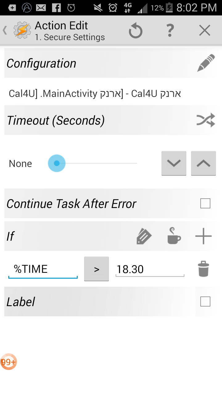

here is my profile can you see what wrong?
