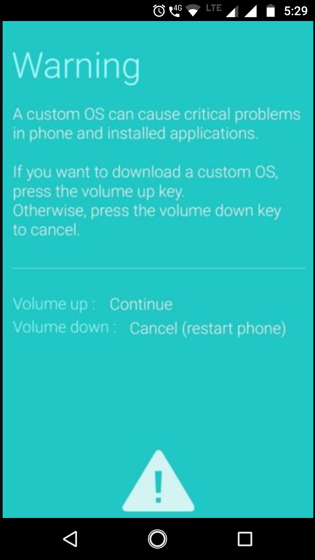

Actually can you tell what are it's disadvantages . Sir I just shut down my tablet ( SM-T310 ) Which is tab 3 and then I pressed Shut down key + Volume down button + Home key . It came to download a custom os which can cause critical problems in device . I started downloading it but after 4 hours it remained the same . Can you tell me what is download mode and it's disadvantages + advantages . Thank you Sir but please help me out .

Sir actually I Was factory resetting my phone by mistake I pressed volume down key and than I saw that custom os . And then I thought It would be a new thing which can make the phone better .

It's unusual for an android device running official software to mention even the possibility of installing custom software, other than telling you that it's detected that you have done so.
But if we accept that this one does, all it's telling you is that if you follow the instructions it will put the tablet in the right mode to install different system software. It's not saying that if you press those buttons it will automatically download a custom ROM (how would it know which one), it's saying that if you press those keys it will put the tablet in the mode where you could install one if you had downloaded it already. It seems poorly worded, and it's surprising that it says this at all, but I can't think of anything else it could mean.
