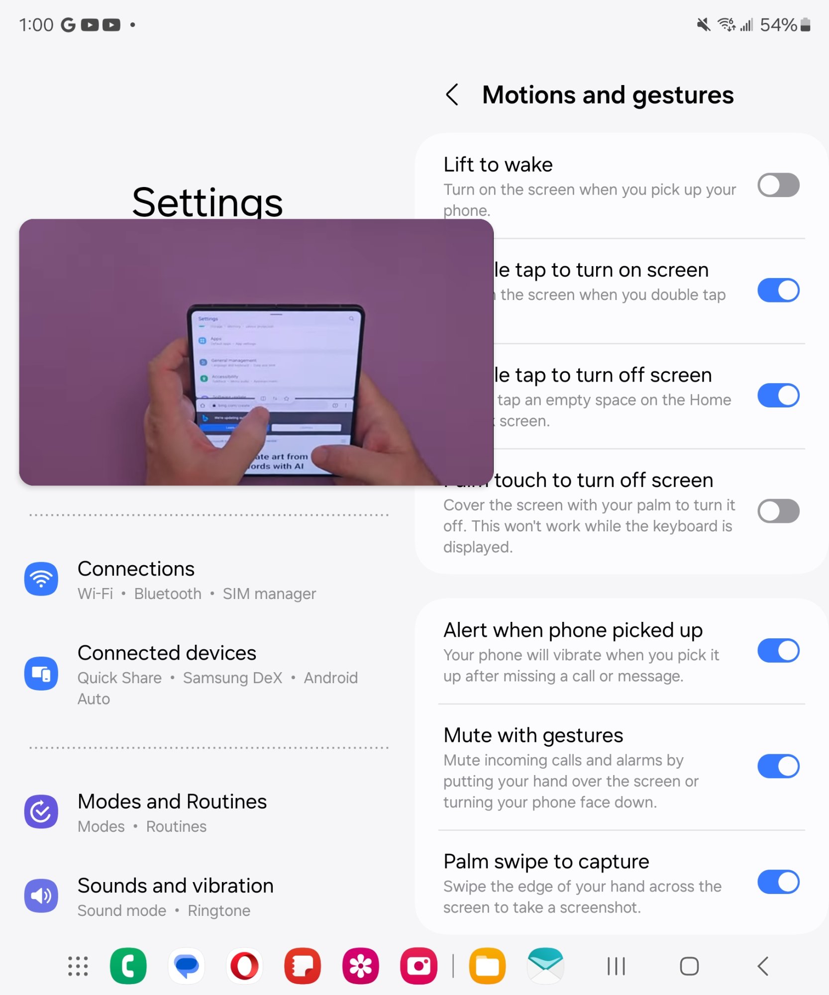

I fixed the lack of notification on this Z Fold 5 that I had on the Z Fold 4. You need the "Alert when phone picked up" option checked. I had that checked on both phones, but I found out that if you have Google messages set as a default, the message alerts will not work (at least for messages). It works with Samsung messaging, and maybe nothing else. I don't know if using Google messaging affected my calls not answered alerts. I changed to Samsung messaging and started playing around with the phone, then the alerts started working, but admittedly, it seems like this new phone is not quite as sensitive at picking up the unread messages and unanswered calls as my Z Fold 4 was. At least it is working.
