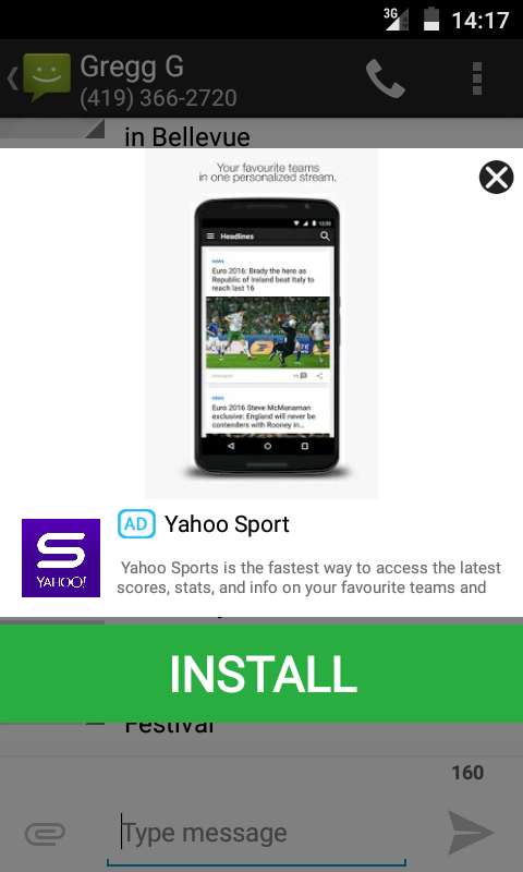

Ads pop up without being in a browser. I've installed the same apps on a different phone and carrier and no ads appeared on it would like some help getting rid of them one popped up in the middle of a text see photo.

Does the ad cover your screen when you go to answer a call or check a text? NOT in a browser?
You can't back out of the ad or pull up home, it just blocks access to everything until you X it out?
Often, the X's to close the ad still download some app or game?

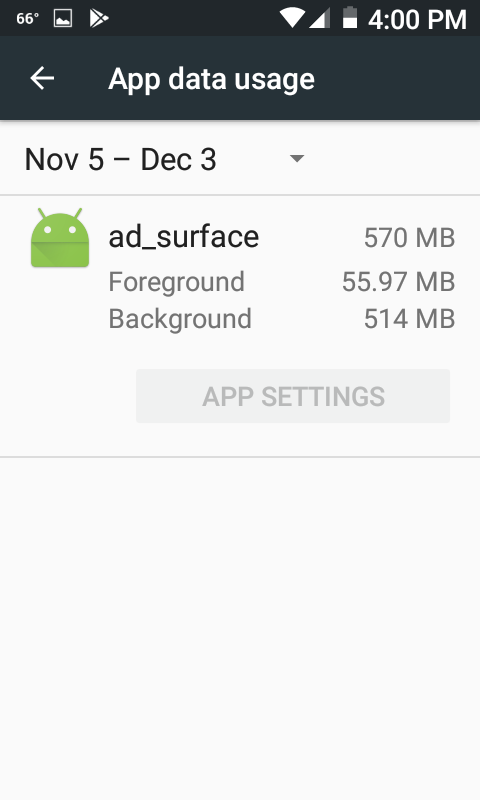

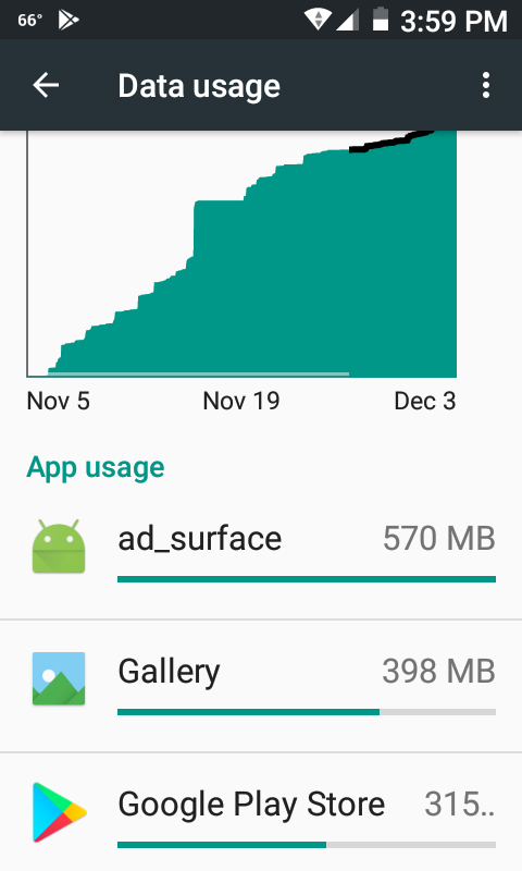

But FINALLY I just found what is probably the culprit, by viewing Settings> Data Usage and there it was, ad_surface with almost 600mb of data this month and I don't browse or do much with my phone, mostly text and use for calls when I am out.
When I touch the app, the "APP SETTINGS" button is grayed out and useless.
I can also find it under Settings> Apps> Touch the 3 vertical dots> Show System and there it is. I am able to DISABLE it there.
I can't find it anywhere that I am able to delete it, so disable is all I can do now and I would like to know if anyone can tell me more about this and how to get rid of it for good (and where it came from!).
I am really shocked that searching for ad_surface yields no results.
I am including a couple of screenshots of the app.

I found this too, before joining this website. It's been disabled, and the ads are still appearing... I know this is a long shot, but what if we were somehow able to remove the app instead of disabling it... Do you think that'd make a difference?
Dinobrat, that is what I am trying to figure out how to do. However, I did disable mine and I have not had a single ad since! I want it gone for good, but the option just is not there and I need a way to circumvent that.

Opened up app permissions. Ad_surface had a permission to draw over other apps. I have taken away that permission and disabled this "system" app.
