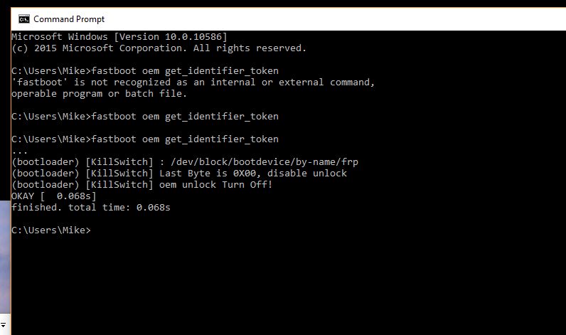

I found that out since I posted. I'm now trying to get the token from HTCdev. It says AdbWinApi.dll is missing. Any ideas where that's from?
Ok, found it and put it in the directory I seem to be using. Now I get this:

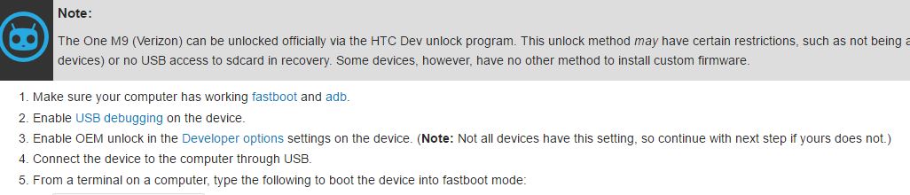

Which I saw last night. I've read others' frustration at this point. Some phones have an "uncheck fastboot in settings" option, but I don't see that. It looks like it wants me to "turn off the oem unlock" but I don't see that in my settings anywhere.
I've been up and down the entire developer options folder in settings and no OEM unlock. I agree it seems like that's the request in the cmd line. Even Cyanogen says it may not be there:
But obviously I just can't continue like they say.

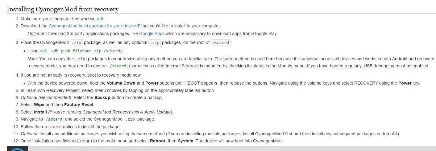

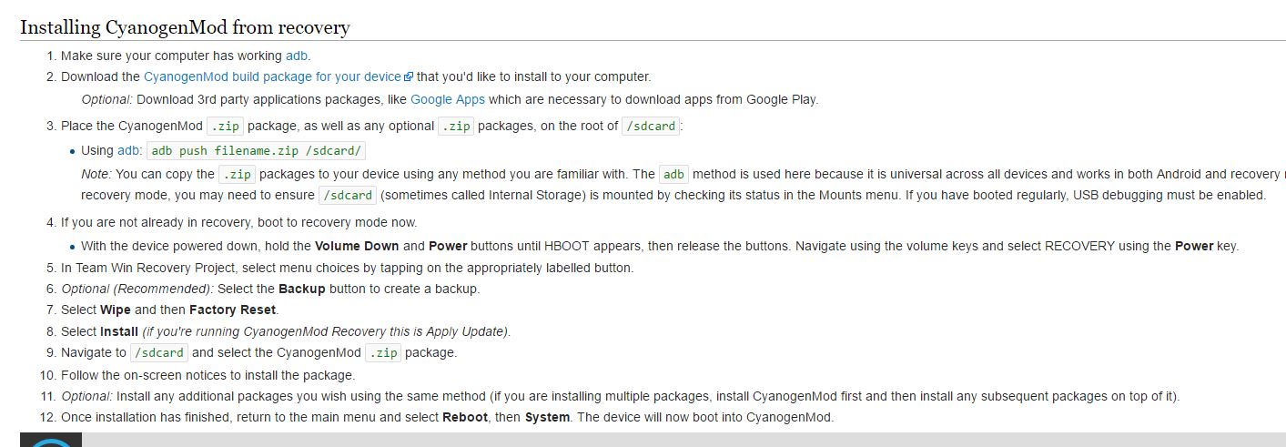

Still on the struggle-bus... If I reboot to bootloader, then I see boot to recovery. I then get TWRP! I choose install, and have to go to a folder called external/sd to find Cyanogen file. I choose that, then get an error that it won't load. I'm back in Verizon stock again. I tried "wipe davlik" but it didn't help.
Here's the cyanogen instructions:
I did Wipe then Factory Reset but there was no "Install" to follow. It just booted to Verizon sense.
So when I try to install Cyanogen from TRWP, I get this error: "Updater process ended with ERROR:7 Error installing zip file /externao_sd/cm...zip" then done. Then reboot, and back to Sense.
HA! Not that anyone's reading this, but I think I made it. After Wipe/Factory Reset, hit the BACK button then hit install. Seems to be loading Cyanogen now...
