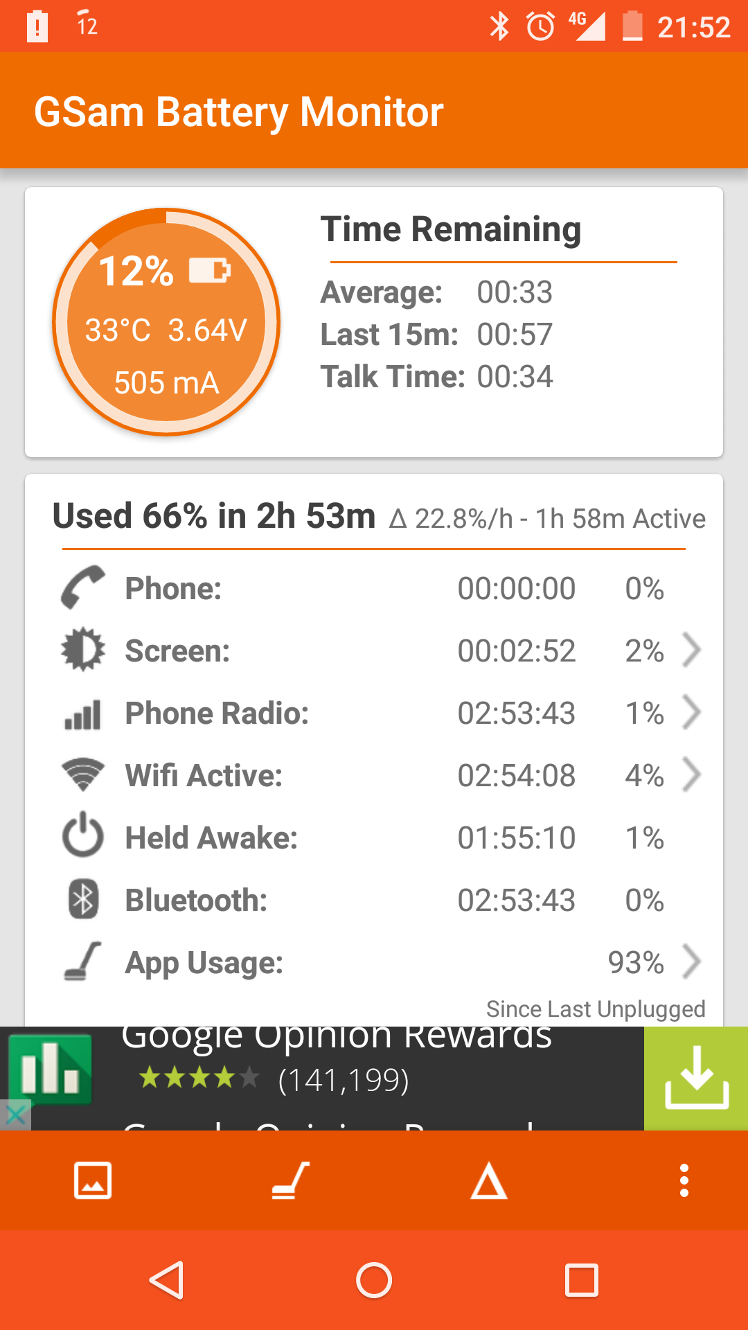

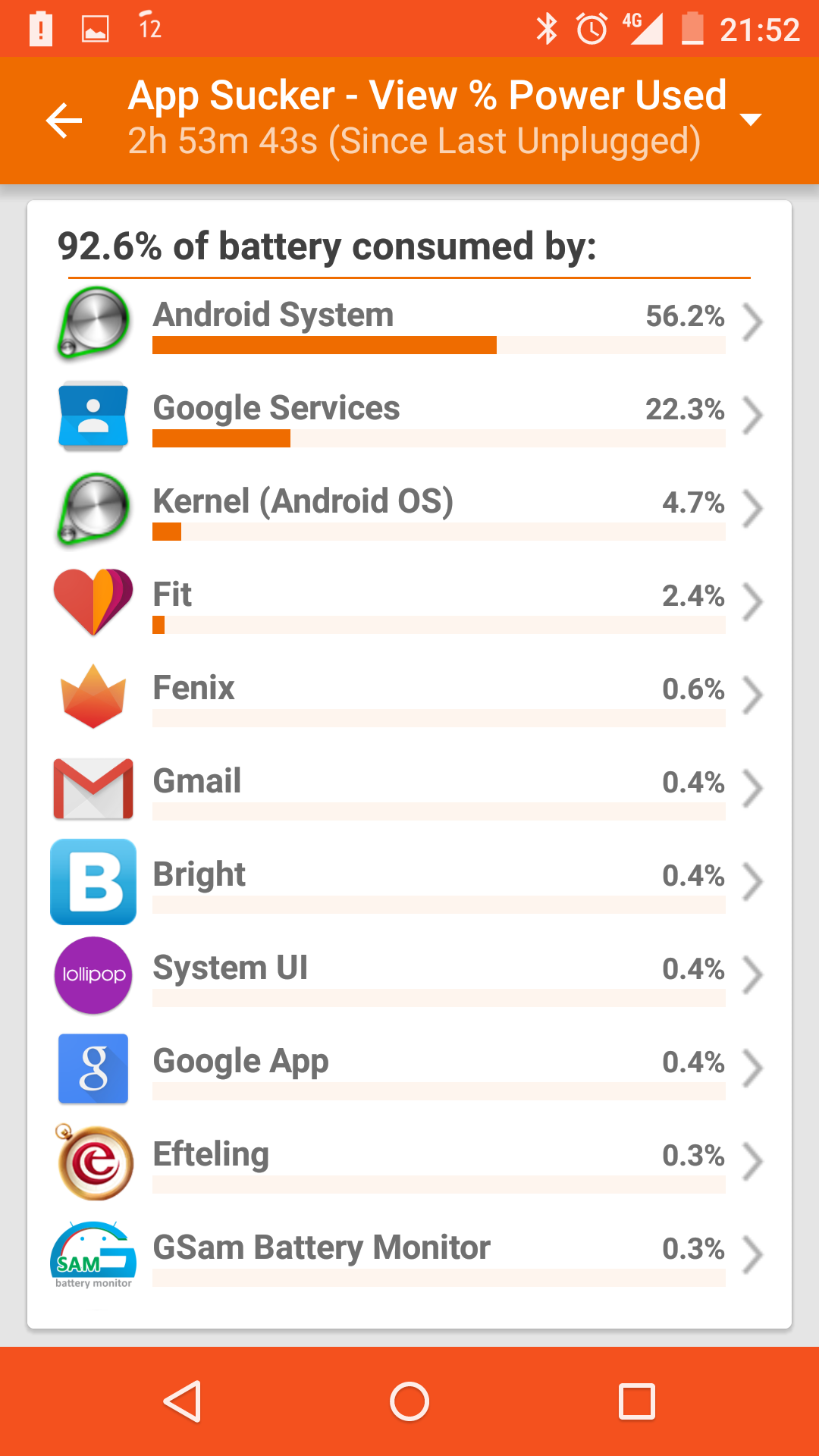

See screenshots. I think it is not a setting but more an OS issue???
Your Google Services are also using way too much power.
Have you tried tapping on "Android System" in that first screen to see whether you can identify in more detail. Also the phone was kept awake for 2 hours out of 3, so go to app usage then select total time kept awake and see whether you can identify what is doing that.
No, it wasnt kept on at all. I turned off the phone before leaving the house.
Upvote 0
That screenshot reports that in the 3 hours the phone radio was on the phone processor was held awake for 2. That's not the same thing as the screen being on, it means that the processor is being prevented from entering a sleep state. So info on what was holding it awake may help identify the problem.
