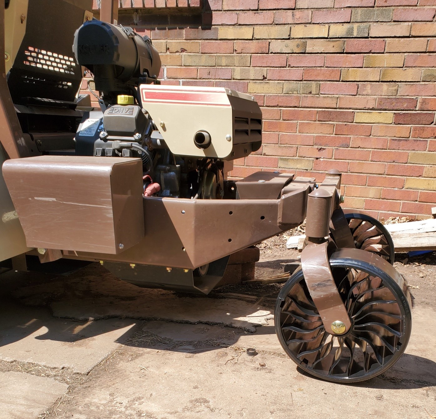

I put a set of Tweels on one of my mowers. My observations:
The not so good...
They will form a flat spot if the mower sits without moving a few days.
They quickly turn back to be round after a few rotations but it makes for a bumpy ride for a little while.
They do cake up with mud and I only assume snow would be a problem as well.
The good....
I likely have 200 hours on the Tweels and they show little wear.
They do not leave tire marks on hard surfaces like rubber tires.
No flats!
My Tweels
I should have added this information to the post above. Obviously, the Tweels I have are not the drive wheels, they are rear casters 13x6.5x6.
They do gather mud in the webbing when conditions exist. I would take a stick and dig out the mud, not an immense amount, out of the webbing. I later found that once the mud dries, it quickly breaks out of the webbing as the Tweel flexes. A google shows the current price of $238 per Tweel and I paid far less for my pair from a local dealer. I could have purchased foam filled casters at a less cost but I have found that they do not last that long.
I would not recommend Tweels for the homeowner mower. The expense to repair a pneumatic tire compared running Tweels is a no brainer. However, a commercial mower, the time lost due to a flat is lost revenue.
Would I buy Tweels again? I have three other commercial mowers and they do not have Tweels. A cheaper alternative is to have a spare tire and wheel ready to replace a flat and address the repair at my leisure. I would never consider putting them on my automobiles.
