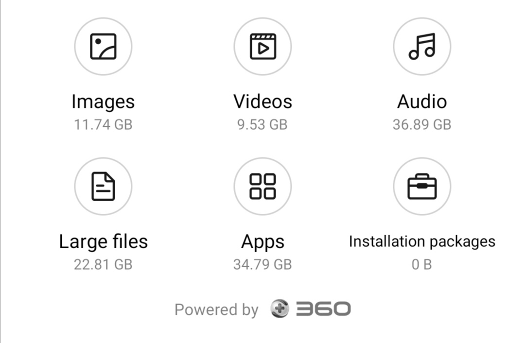

If an essential database was deleted, could be the Oxygen OS, or some other cleaning app, had a clean up on files it thought were junk and couldn't be reconciled.
I know Oneplus's Hydrogen OS has a somewhat aggressive file cleaner provided by Qihoo 360, not sure about Oxygen OS.

Does your Oneplus have any sort of file cleaning in it?
Things like Powered by 360, or Powered by Cheetah Mobile. These can be rather aggressive at deleting things, even if it's stuff you want to keep. Quite a few Chinese phones have them preinstalled as part of their OS, baked in.
These didn't come from Google of course, and so aren't usually a part of Android.
