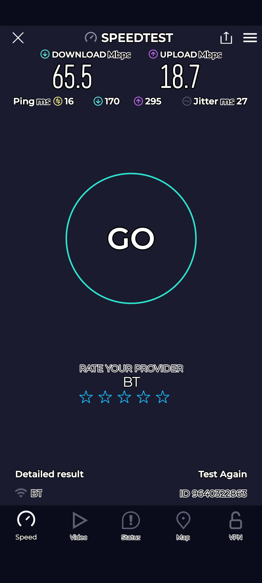

No, they aren't adverts - they are part of the normal operating system. I probably used a misleading phrase calling them popups, which, I gather, has a specific meaning - what I meant was that they just appear for no good reason that I can see. I'll attach a screen grab I just got. At the scale it shows up here the text is simple to read, but on a small phone screen my 80 year old eyes can't cope. It has used the double lettering where it says "rate you provider" but not BT below it. The BT above "speed" has used the odd lettering.. The word "speed" at the bottom Is normal but "video", "status", "Map" and "VPN" are. The "ID 9640322863" above is what I was complaining about - at phone size I cannot read it at all, although on the magnified screen grab it is fairly clear. On the phone I would need to expand the text or use a magnifying glass. There are other bits on this screen in the same double font - "Mbps" but not the words immediately adjacent to it, "ms" after ping and jitter. This grab is not the best example, but on a phone screen with different (particularly light) colour background any text like this is unreadable to me. The more I look at it, the more I think it might be the normal font with weird shadowing background applied - anyway, this is what I would like to prevent if it can be done.

Having carried on searching myself, I have accidentally stumbled on the answer to the problem. It was not a separate font. When I set up the phone, one of the display options was to enable high contrast text to improve. Having, as I mentioned, poor eyesight, I set it on. It would appear that far from helping with contrast, this setting changed some of the text (why only some?) to the double letters that caused the problem - making readability much worse, not much better. My guess is that it might have worked has I not been using dark mode. Either way round, the Android devs got it horribly wrong. I've unticked the setting and the horrible text has gone away. Some checking showed that the items previously "doubled" were quite low contrast items, but they are now at least readable. It's fairly typical these days - make a half hearted attempt to change something, only to not check out all the options and make it worse.
