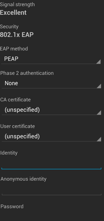

Would it help if I posted a screenshot of my 'attempt' to access the network (the login screen)?

Anything would help.
Perhaps this?
Yeah man, how did you do that? If I have SSID that is auto detected, I hold down tap I just see Connect to network, I don't see forget or modify.

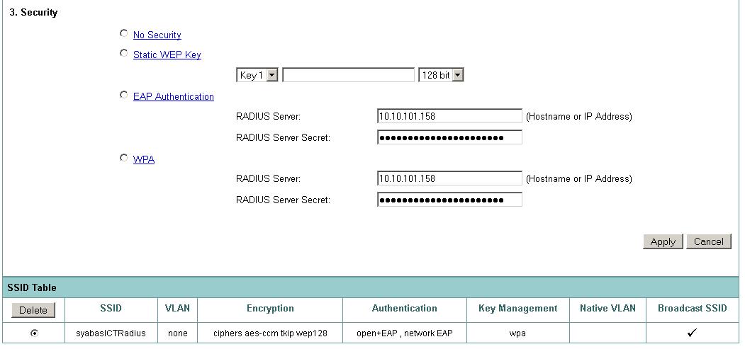

I am sure it's something to do with the encryption settings, would it help if I posted my AP's encryption settings?
Here is the current SSID setting.
TBH, I only set the encryption as cipher with all that info because otherwise the AP does not allow me to use WPA.
For WPA it must be a ciper with atleast tkip-wep40

I really think this is due to the encryption method I selected at my AP. I have no idea what type of encryption I'm using, but all I know is I have to set it up as some type of cipher with TCKS + Wep40 bit atleast, in order for WPA to be in use, which leads to the Android device detecting the right type of encryption and allowing me to use PEAP.
But I believe, that in my AP, I need to change the encryption to something else. Anyone knows about this stuff?
Your AP handles things a little differently. Set it to CCMP+WEP, and see if you get a solid secure connection.
Hey! I managed to resolve the issue. I changed the client authentication method to WPA Mandatory instead of Optional.
In order to do that, I had to change the encryption method to AES-CCM.
