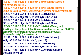

I've made the same steps like you, afterwards tried to enter hostname, got google search page (ie. not found). Then, I've tried http://hostname and it worked. I've tried it in 1.6 and 2.2 emulator and was working well on both.
Can you pull hosts after pushing it? Just to be sure, it's updated (I got error on 2.2 due to low space and had to use 256MB memory).
I've tried pulling and pushing symlink in /etc and also real file in /system/etc, both with success.
Good luck!
PS: I've installed aLogcat (I don't have .apk, have emulator with Market enabled) to see log messages in emulator. On 12-22 17:58:13.090 (see screenshot) you can see the adress pulled from /ets/hosts (I've enterted http://kejly into browser).
