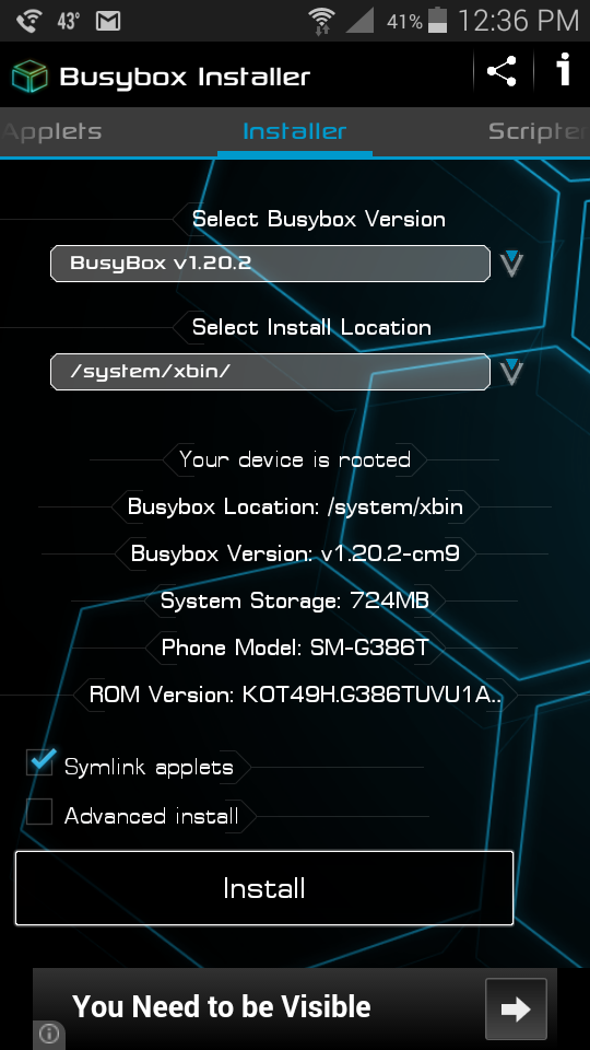

Attached below is the picture of the completed "BusyBox" install via the app to use that you mentioned. I left everything default such as the /xbin directory, ect...
Please advise as/if you can of what I may have done wrong, lol... I am afraid to go the route of installing TWRP via odin because for some odd reason, I am getting an MD5 mismatch (see that thread where I posted) in regards to the prefered odin version linked in that thread.
