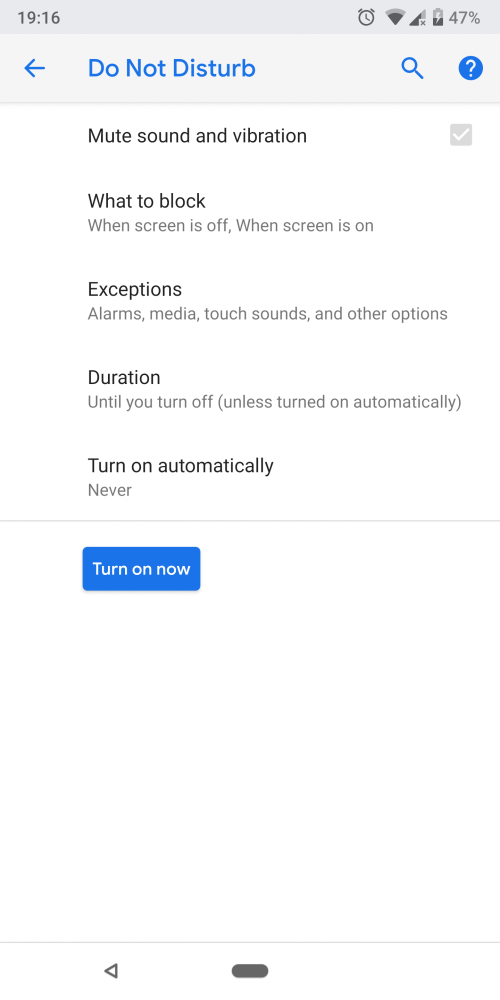

When I click the icon to put Priority only, I noticed that the volume automatically goes down to zero and I cannot override it. What am I doing wrong?
I don't know. I've not spotted any setting for this, but mine doesn't do that (regular Pixel 2, May security patch).

Just as an experiment I switched to a guest account, which Will be on default settings, activated DND and then tried to set the volume. The volume control worked fine. Maybe if you do that test you'll be able to confirm whether your phone works the same by default or not (i.e. whether it's worth trying to locate some setting that will change this)?
Ah, you are running the Android P beta - you didn't mention that! Different behaviour could be deliberate or could be a bug. Since you are in the beta programme I suggest giving feedback to Google on this either way.
The box you mention doesn't exist in 8.1.
