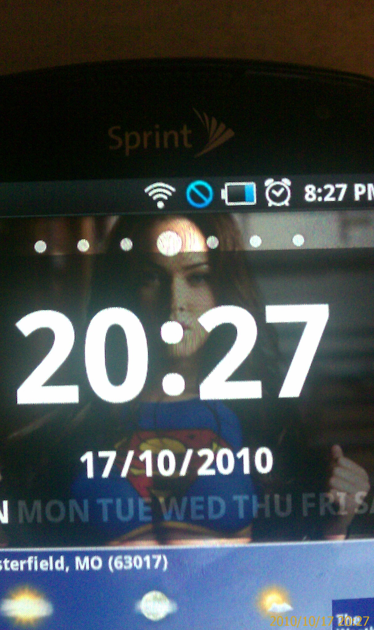

Ok I just got my Epic from the store yesterday. I have been running on a TouchPro 2, stock rom. Other then the weather hack, the only other hack I had on it was to force roam. When I am at home I am luck if I get 1 or 2 bars from sprint. I live outside of the St. Louis area, about 70 miles. There is a US cell tower maybe about 1/2 to a 1/3 mile away from me. On my TP2 when I roam I get full service cause the tower is so close.
Now I needed the same thing from my Epic from Sprint. So I found this app, followed the instructions for rooting my phone, which I have 0 idea of what the purpose of that was and it worked just fine. I dl this app, paid the money for it, and am lucky when I run it to force roam if I get 1 or 2 bars if I am lucky.
So what am I not understanding here? Am I doing something wrong? Is the phone not picking up the tower? I am so lost and confused. I am just about ready to take the phone back and get a refund. So far I am not impressed with Droid at all, it can't even get my folders for my Hotmail.
Seriously though, help me here?!
for those who disbelieve what I am saying,here are a pick of each phone that i just took a few minutes ago. both on force roam.
still looking for some help here...
ok i also figured out that i am roaming on my TouchPro 2 on us cellular, but on the epic it is trying to roam on verizon. might explain a lot.

Hi Mr (Dr?) Evil,
You aren't doing anything wrong. And don't worry about the $$ part, if you are dissatisfied I can always refund your money.
The WinMo phones have "roam only" compiled into the firmware but it's hidden. You can expose it by editing the registry.
With the Android phones, the "roam only" option is not compiled into the firmware. That makes things a lot more difficult since we don't have access to the exact source code (unless you run something like CM6). There are even differences between forcing roam with HTC phones and Samsung phones (with the Samsungs being more difficult).
When put in a "roam only" mode, the Samsungs will only roam onto 800mhz networks (this doesn't apply to HTCs), which may explain why it's roaming onto Verizon in your area. Otherwise, it may just be preferring Verizon towers, and I'm not sure why since the source isn't available.
Anyways, this has always been a drawback compared to WinMo phones.

thanks for the reply. i am not as concerned with the hotmail thing, i am working that out slowly.
as far as the roam thing goes here is some updated info on that.
I left it on roam only and it does want to stay on verizon for some reason. but if i leave it on automatic, it will roam over to us cell and will stay for a bit but never stay for a long time. it is usuable and as long as i am using it then it stays on us cell.
so it is possible for it to roam on to the us cell service. so if it can roam on to the us cell service then it is something inside of the forced roam program or the os it self that is directing it to verizon only. which is a bit of what you said. but, if it will roam on to us cell service on its own then there has to be a way to include that into your program.
since i have no idea how to do this, i can only guess as to what I might do. so maybe 2 different roam options or an option in general. one to roam on any network, one to roam on cdma(verizon), and one to roam on non-cdma(us cell or like them). guess that might be 3 options. but really one 2 would work at 1st. one for cdma and one for non-cdma. should nt be that hard to figure out the frequency and what it takes to make the phone search for it and lock on.
Thoughts?
