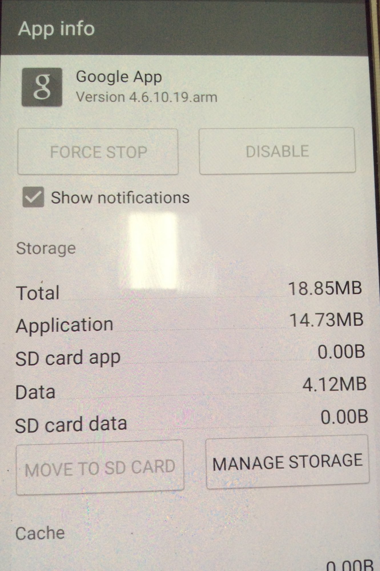

The easy fix - just open the app drawer, drag the google app to app info and drop, select disable, when prompted choose you service providers default launcher

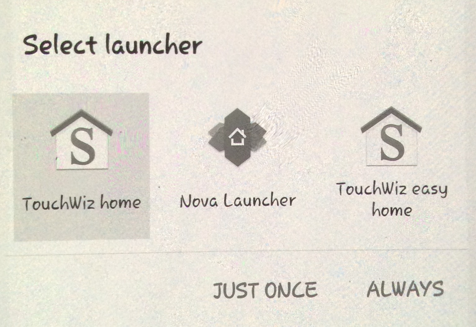

One of the suggested solutions online was to install any launcher from the Internet, to promote the select launcher to appear in safe mode.
Did that. But it seems I hit another dead end as non of the launchers that appear seem to launch in safe mode! Or turn on any additional settings or even the mobile's wallpaper.
The useless three launchers are: ThouchWiz Easy Home, ThouchWiz home and Nova launcher.
I'm clueless������, and the timing couldn't get any better.������
Please help������������
I did this while not in safe mode, I would suggest trying it again in the normal upsm. The standard touchwiz is the launcher you should choose, the one you download doesn't matter, it is only to trigger the option. Also you should not need to perform a restart after the install. Hope this helps

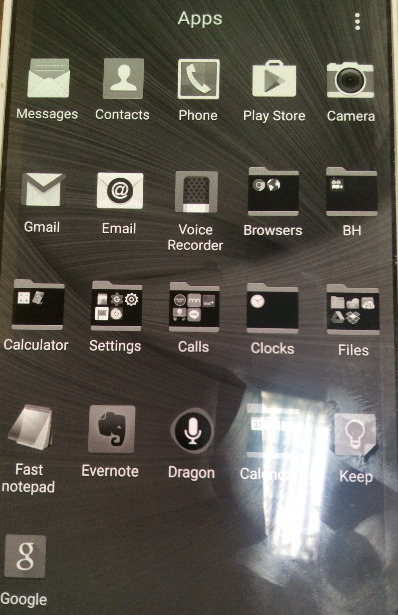

Followed your suggestion. Phone will still launch in grey.
Tried all launchers in image. All same result. Ultra save mode doesn't end.

Thinking of installing GoogleNow then disabling it. Might trigger something in the process. Doesn't seem to make sense though.
Senseless issues might need senseless solutions besides factory rest.
Yep
In the app info the force stop was the only clickable option.
Clicked it, nothing happened. Cleared app cache. Also no effect.
