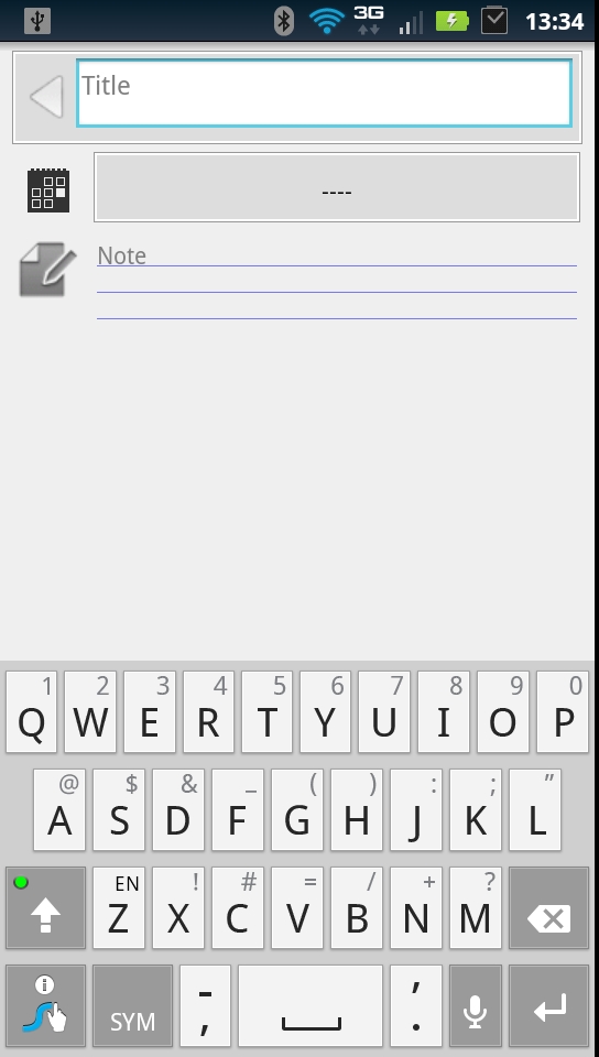

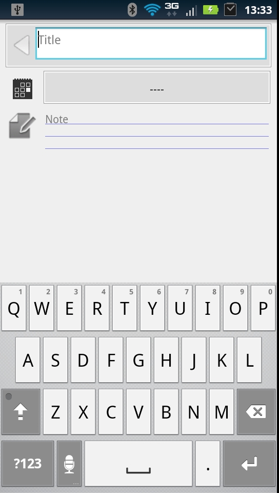

Stock Swype is the exact same amount shorter than the multi-touch KB.
Screenshots to prove it: (I'm using the SSI gTassk app to show the difference, but it also exhibits in GMail, etc.)
dude, you're awesome!
thanks very much for checking that, appreciate it
