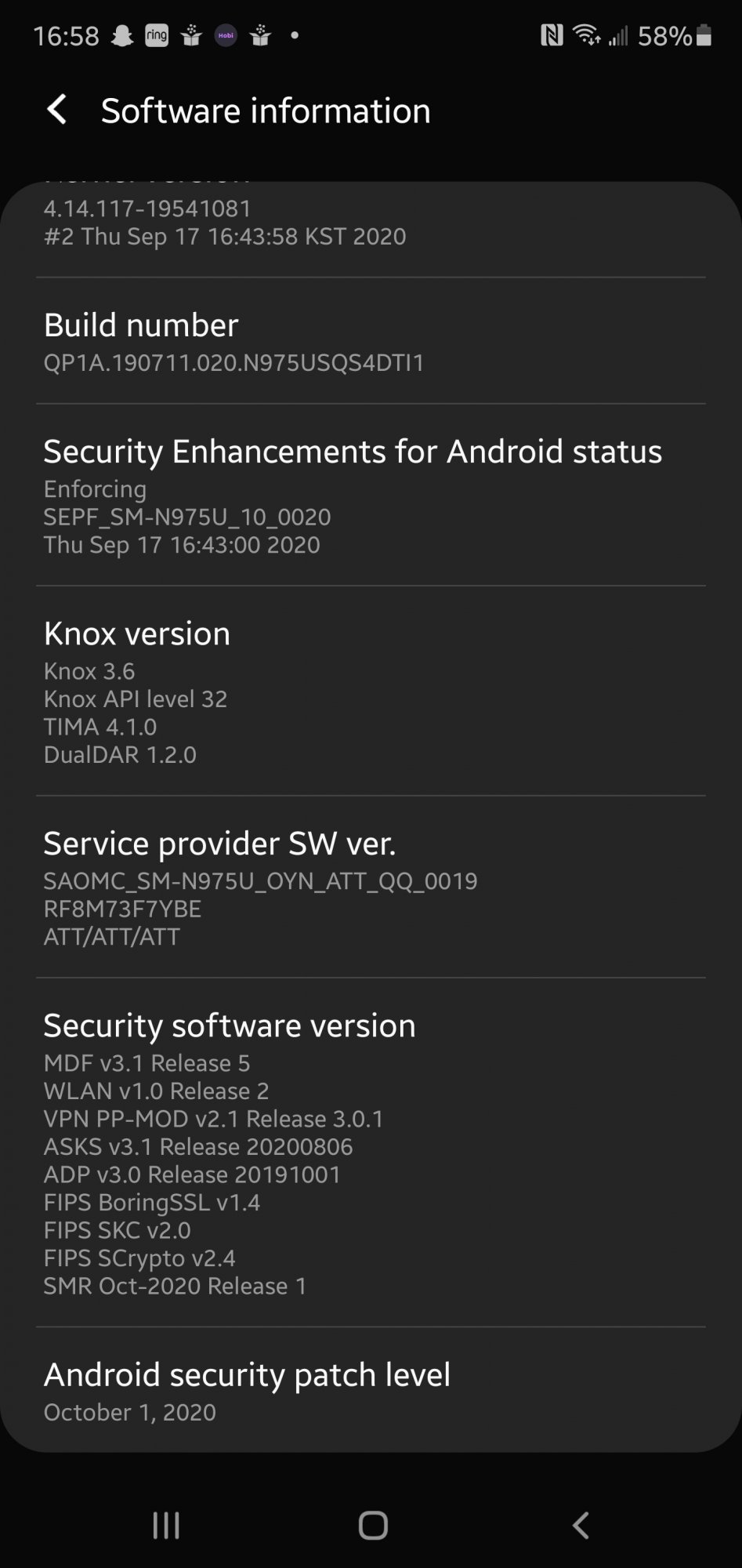

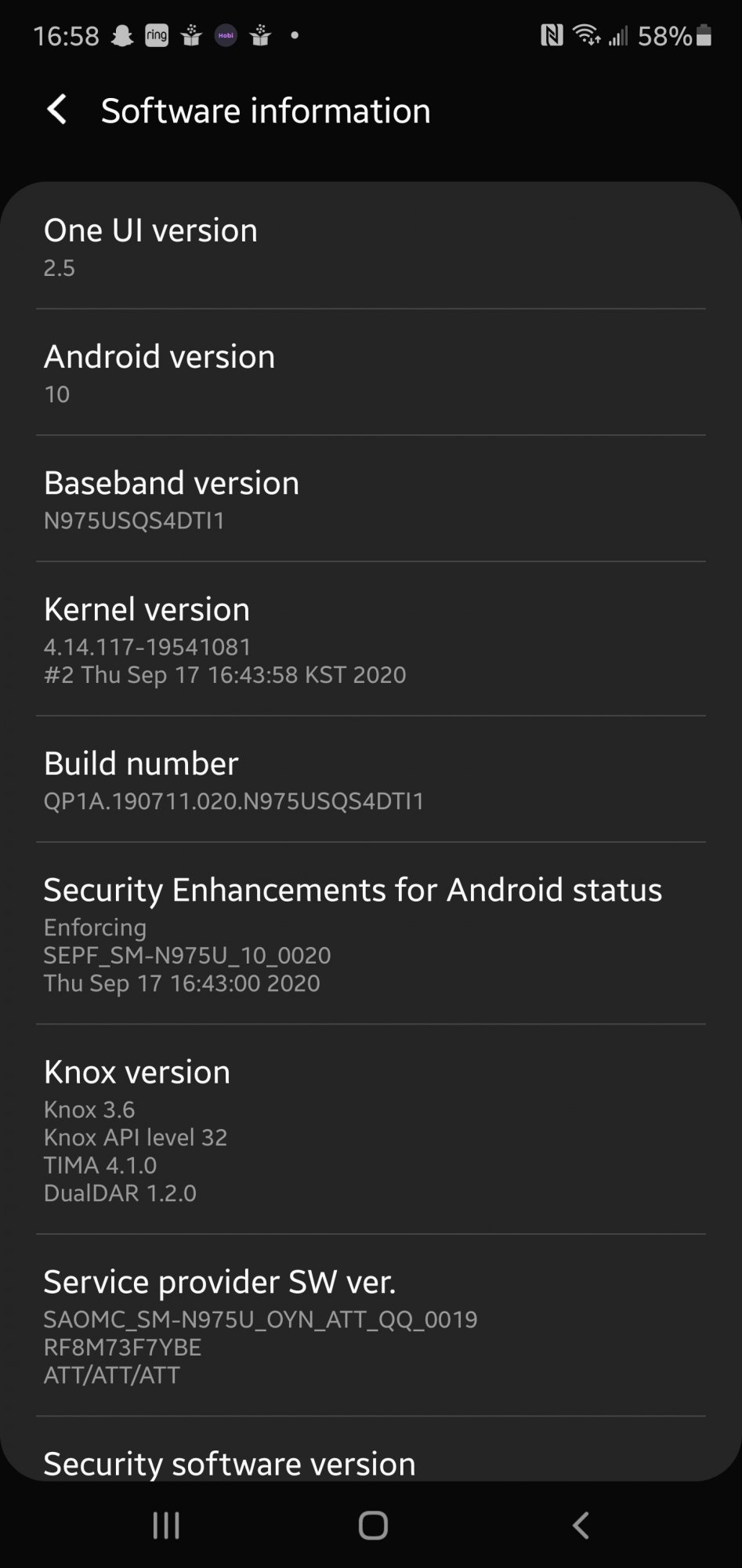

I think I got this update you're taking about , the other day . Screenshots attached of what I'm running now.

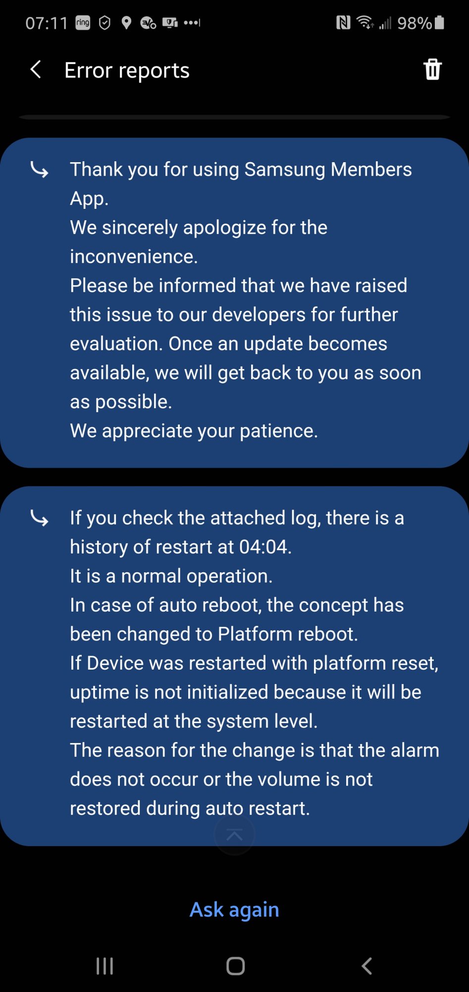

That's what I thought. Thanks for your hemp and input! I guess we're the only 3 that use this feature .. Lol.. I'll have to wait for the update for me in the States. But at least I know, they know about it and are fixing it. I've even posted in the "Samsung Members" app on my phone, where I was able to upload a diagnostic file that I was able to take right after the restart failed , so they were able to see what happened.

So, it is looking like the config updaye I got allowed it to do the new, in process reset, that allowed the proper alarm tones to work and so on. I was annoyed at every tone being my ringtone untill I logged in to a rebooted phone before.
totally makes sense that personal data is ot loaded until login, rahter than at boot like it used to be so I understand why this change was needed from a full reboot to a syystems restart that would not trigger visual evidence that it had happened. In this instance though A notification would be very helpful to tell you it had happenenned, and with a different sub menu to other system notifications you may have ignores in the past
How did you find this out? That's exactly what they told me, but I couldn't find any info on it. AND I agree with you 100%! There should have been some other notification or something stressing this . Thanks for your help!
